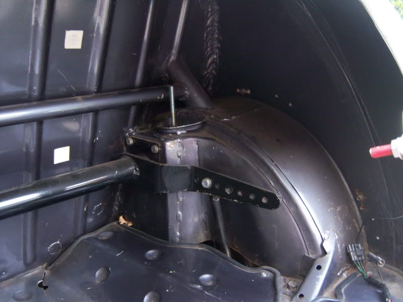

Heres the one in my miglia.Only photo i have to hand but will post some more when i get chance if you like?

cheers rosco thats exactly the setup im planning to build, do the drop links just go onto the end of the stub axle?
If you could get some other pictures that would be great.

The drop links go onto the end of the radius arm which has an extra attachment from standard.The drop link can be swapped between positions on the roll bar and on the radius arm which alters the stiffness.I will try to get some more pictures over the weekend.
