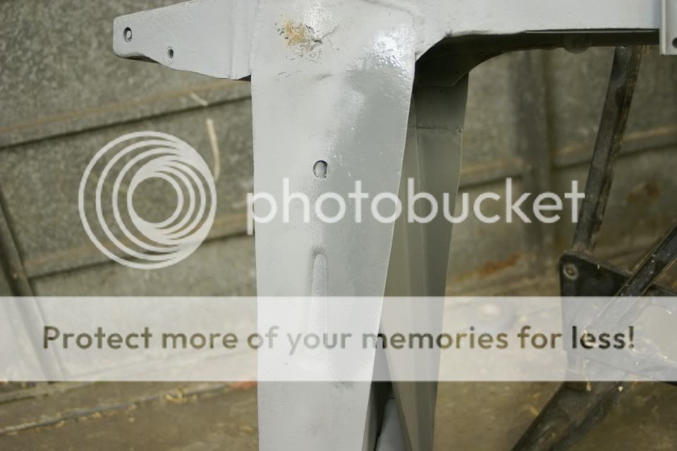

Posted 31 July 2010 - 05:46 AM
Right here are some of the seams that appear to be splitting apart. Someone has drilled extra holes in it too I think.
And finally a seam I have welded up and sprayed, it still needs tidying up a bit though I just ran out of time that day:
(In Pic 2) Should I use a 1mm disc to cut along the seam open it up a bit, clean it all up then seam weld it all back together? Or should I just cut the top section out, clean and reweld new metal in?

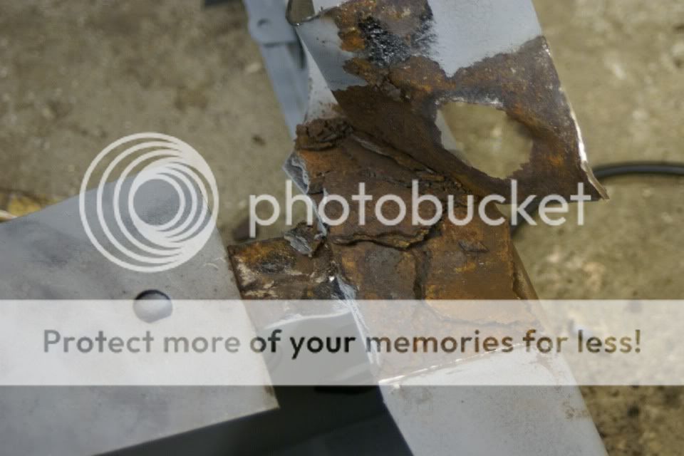

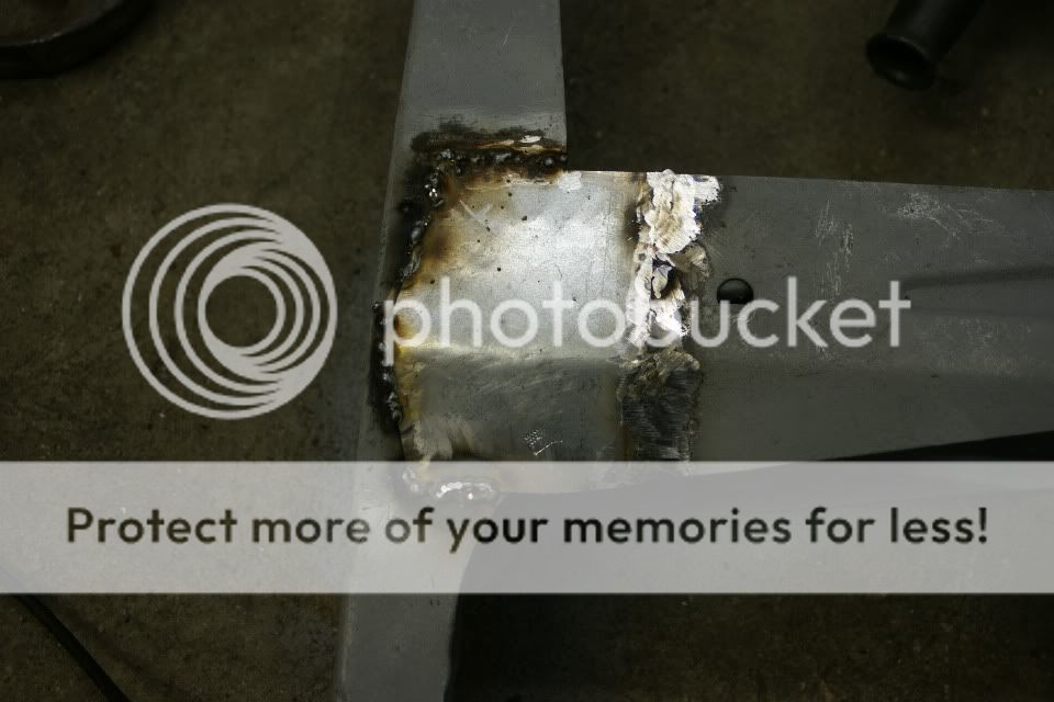

#14
Posted 01 August 2010 - 07:59 AM
I bit the bullet and decided to start chopping and look what I found:
I ground it back and rust killed it before applying some zinc primer and have almost finished welding on the repair patch. It is galvanised so should be better in the future.
I did get the 'extra' holes filled in and finished though:
#15
Posted 01 August 2010 - 08:47 AM
Hi Scott not bad but it looks like you left the galvanise on the metal where you welded you need to grind it of where your going to weld and it gives off a poison gas not good .From the picture i would say that you need to turn it up, the weld looks like blobs sitting on top of the metal .Try doing it on a scrap thick bits first then try thinner as you get the hang of it .
