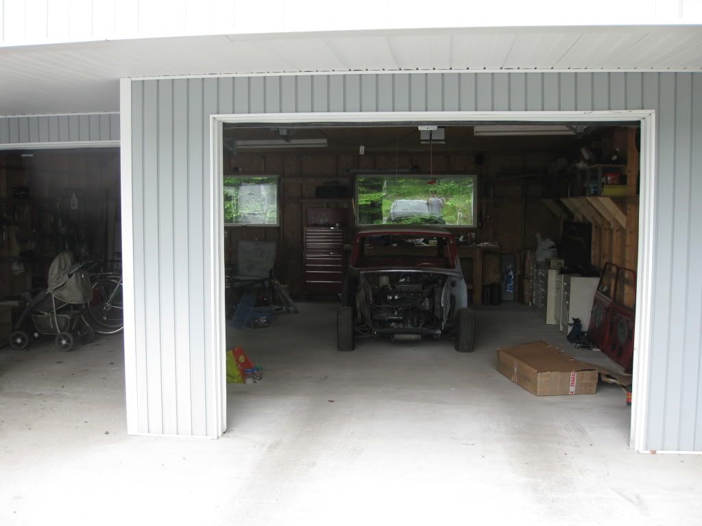

Brought the Mini at the new house about 3 weeks ago, here's the place.

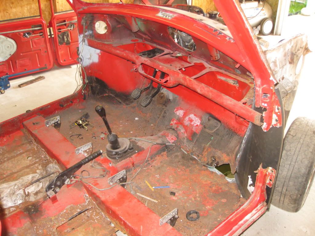

I got serious into removing everything to have a clean bodyshell to work on, so everything's going out, wiring, engine and all. I'm planning to build a spit kit with stevede's for an inspiration because I have a lot of welding and repairs to do under the Mini. I must get a welding machine soon, too.
Question: When you buy a complete new wiring loom, are the wires the same color as the originals and all? I documented the removal with lots of pictures but I'm so scared of all electrical stuff, I hope to figure it all right when I get to put it back into the car. Plus, I heard the looms don't come with instructions or anything.
So that's what the Mini looks like right now. I'll be ready to drop the engine along with the front subframe pretty soon I guess.

Done some things recently. Bought a brand new welder! My welds are still a bit messy but I'm getting better with practice. Worked a lot on the right door post area, since this was the favorite part of Mr. Rust.
Cleared the rot...
Cardboard...
Metal
With precious advices from Sonikk4, I finally positioned the new door post, where the door bolts in.
Thankfully, nothing moved and the structure was still intact even with all the metal I removed previously.
I had to tack-weld the post with the door in place, done it a second time to improve the positioning, welded it properly and thankfully the door still fits! Was a bit of a tricky job though.
I still have the inner closing panel to fit, then I can work a the scuttle corner and this area will be kinda sorted.

Love it! keep up the good work. I also love the big garage, quite envious. :)

You have certainly been having a good go with the repairs. The floors do look really bad and now it may pay you to think about replacing the whole floor assembly.
This will include the rear heelboard assembly and cross member as well and right up to the front toe board. Although this is not a cheap option it will cover nearly everything that needs to be done inside the car.
You can buy half floor sections with the heel board and cross member separate if you want to go that route. Try this company their products are really good, i have used them for their outer sills and jacking points http://www.m-machine.co.uk
Their parts catalogue is really good. Its a downloadable pdf.

Great car, and definately envious of the garage! :thumbsup:

thanks guys for the comments! honestly, I'm in love with the garage!!
