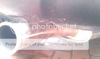

So I finally finished replacing my exhaust from front to back, at a cost of £250 cheaper than what Kwik Fit quoted me a few weeks ago!
The car sounds beautiful now, but the end seems to be sitting much higher than it did before and it vibrates against the bodywork when I rev the engine.
Any suggestions on what I can wedge between the two that will stop them rubbing but won't just wear away or is it a case of trying to take more of the bodywork out?

My back box is hanging on two of these:

Could you post some pics of how it's mounted? You may have to bend one of the hangers down on the backbox to get it to sit properly.

how is it hanging on them ? in that picture have u it have in the hole on the left and right or on the H section in the middle ?

Mine is hanging from the holes on both ends.

Try packing the clamp out with dome thing and just bend the body work a LITTLE up away from it. I had the same and worked for me. It's really close but it's not rubbing.

could bend the hanger hooks to lower it ?

Not a bad idea. Will try this tomorrow.
