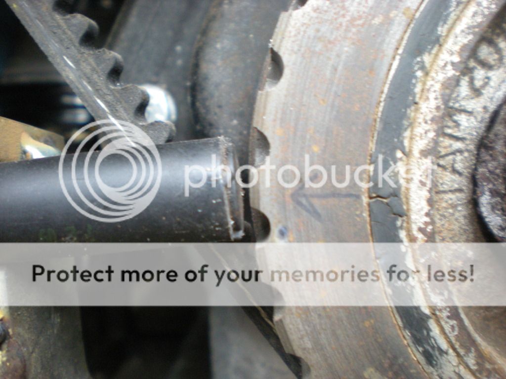

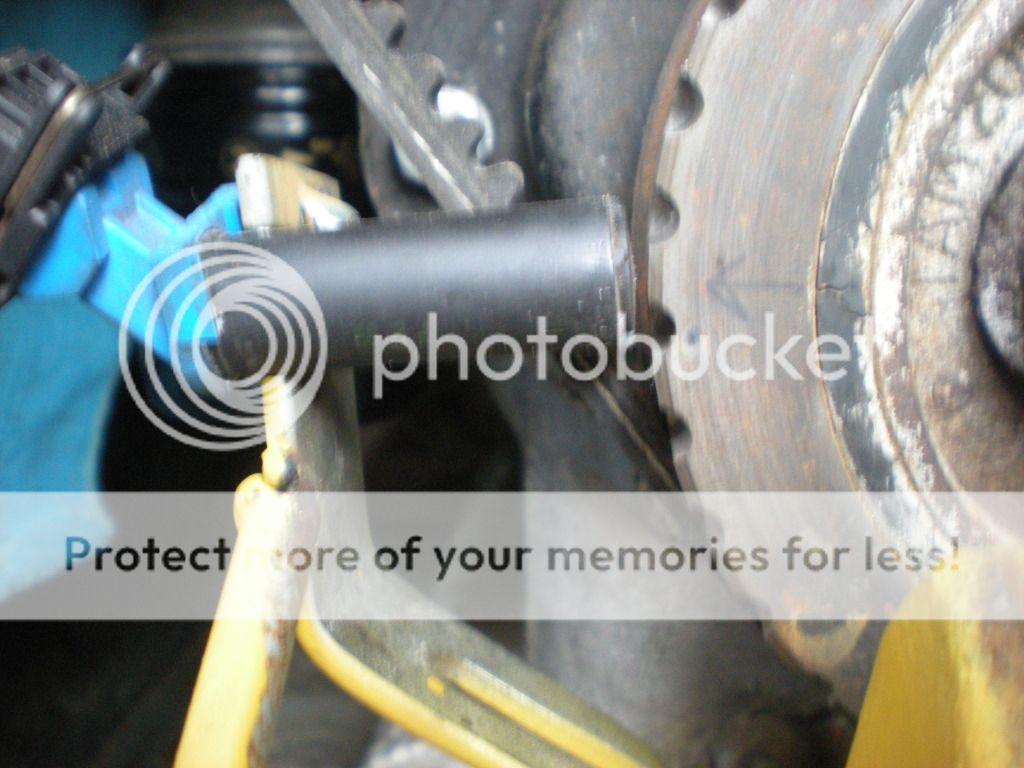

People Running megajolt, am I going to have issues with my sensor, im unsure. The arrow points to the 9th tooth after the gap (I didnt count the gap)
Cheers
Im concerned with the angle, the gap is .8mm I measured it with a feeler guage :)

.8 is fine, the cut outs don't look very deep though

its the angle of the sensor im concerned about :s

angle is fine, that bracket needs beefing up a bit to stop vibration issues

As Charlie T says, the angle is OK but the cut outs look very shallow for a trigger wheel.
