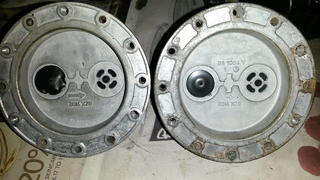

@sledgehammer - I have opened the fuel cap while the car was running and have not noticed a difference. I would think there would be a change if that was the problem.  I would assume fuel is good as I have ran multiple tanks through while trying to diagnose.  We do have up to 10% ethanol in our fuel.  Nice picture.  My fuel pump is mechanical. I can't tell if yours is mechanical or not, but would there be a difference in ethanol messing with a mechanical/electrical pump?
