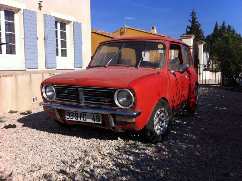

I'm 40 years old and have had a lot of different Mini during the past 22 years.
I still have some, as a 1993 Rover Mini Seaway, a 1979 1100 Mini Special (BMW K head engine in progress), a 1300 Innocenti Mini Cooper (waiting to be restored) and a 1974 Mini 1275GT.

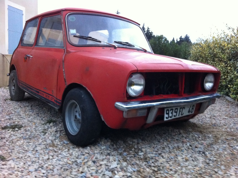

Here is the GT when it arrives home
Looks not too bad... but I will have some surprises!

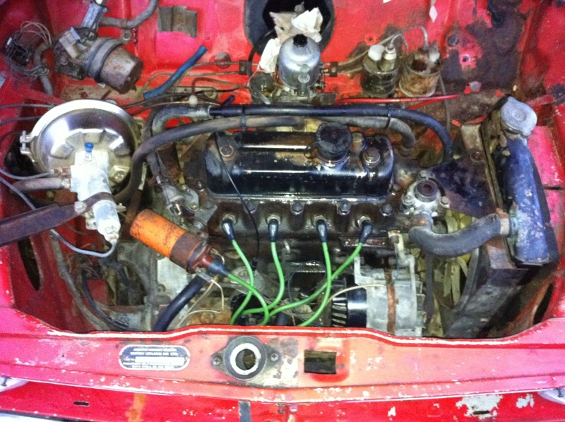

A+ engine, from an Inno 120

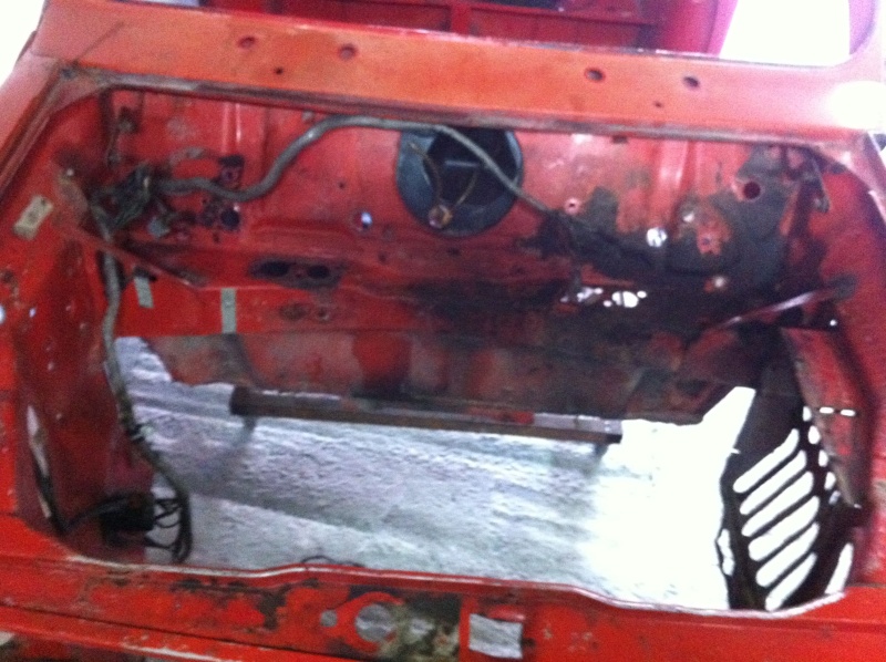

So, I decided to make a whole restoration and started stripping the Mini

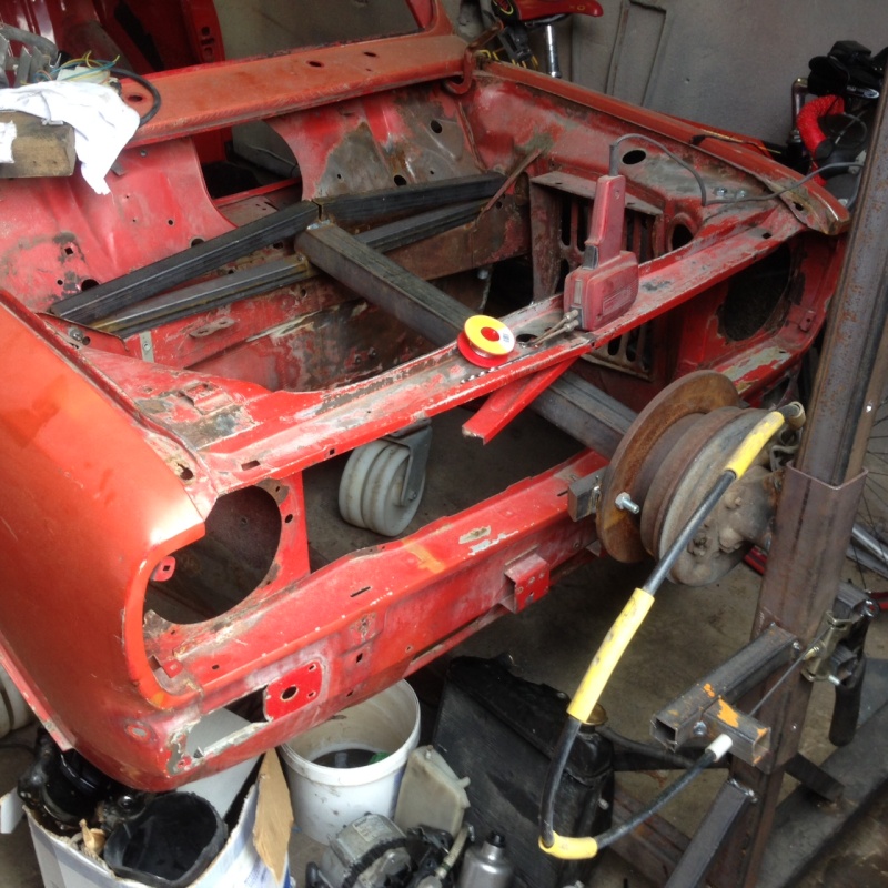

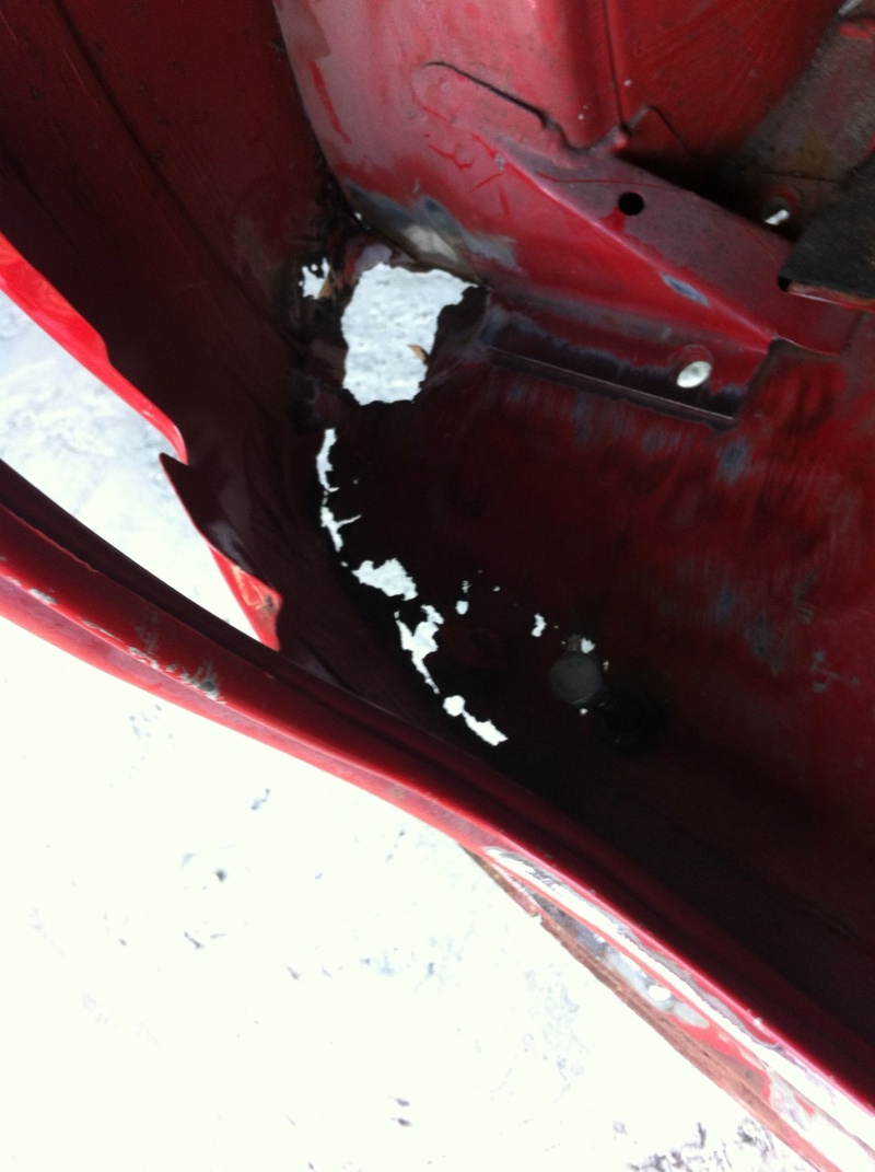

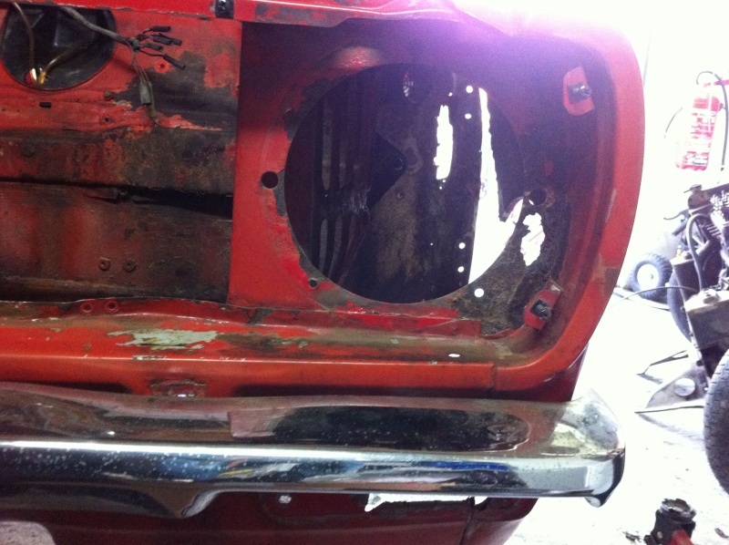

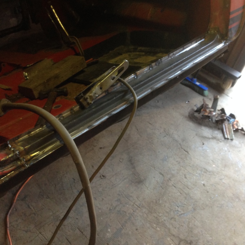

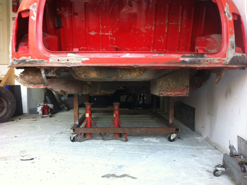

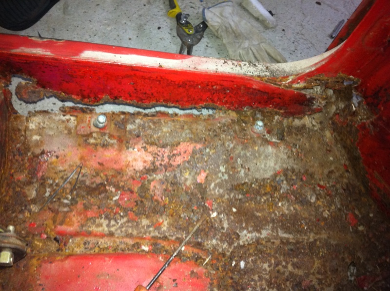

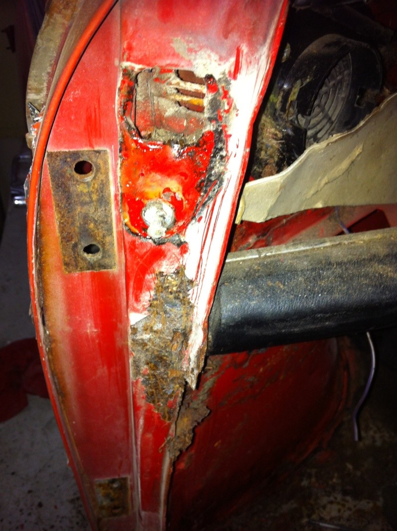

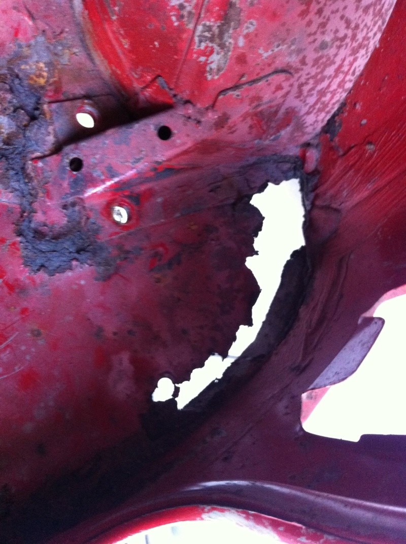

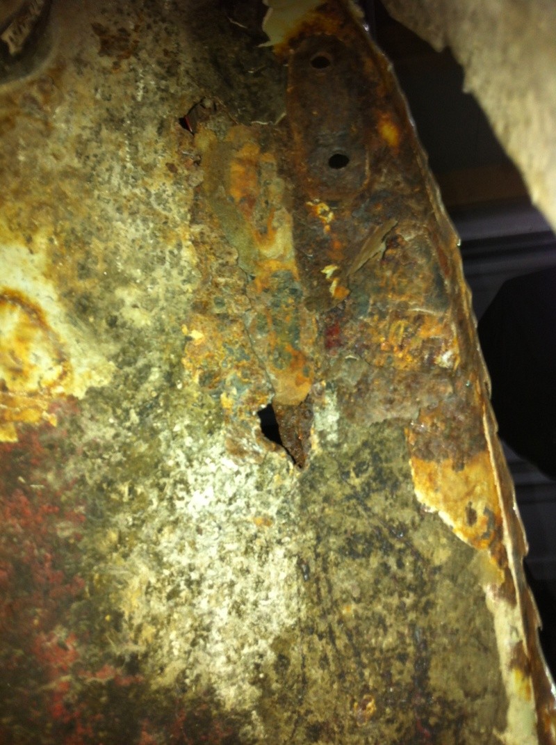

And of course, found some rust in usual places

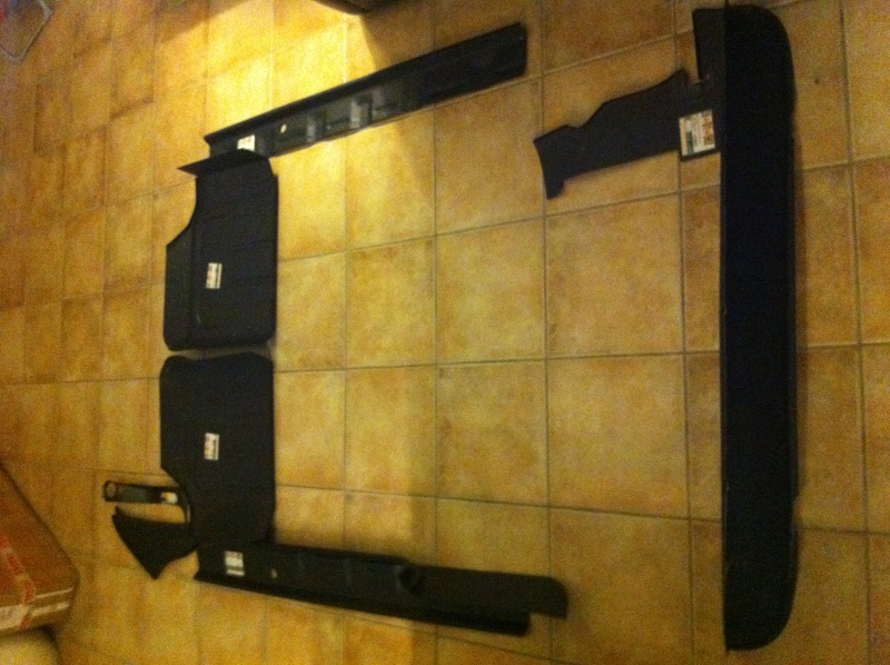

So, I emailed Somerford and few days later, received some parts

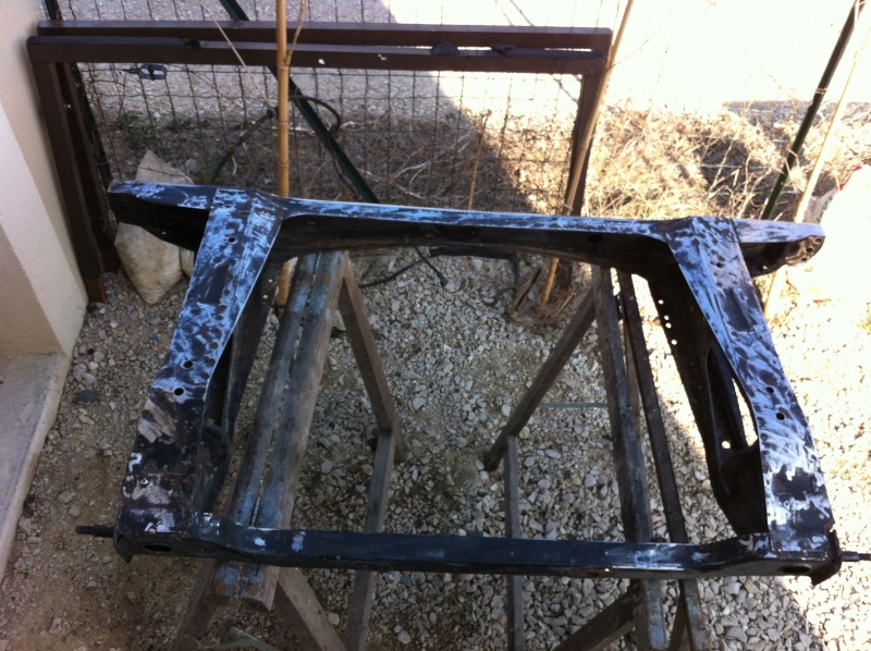

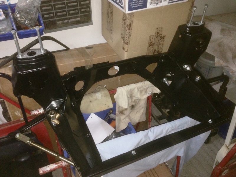

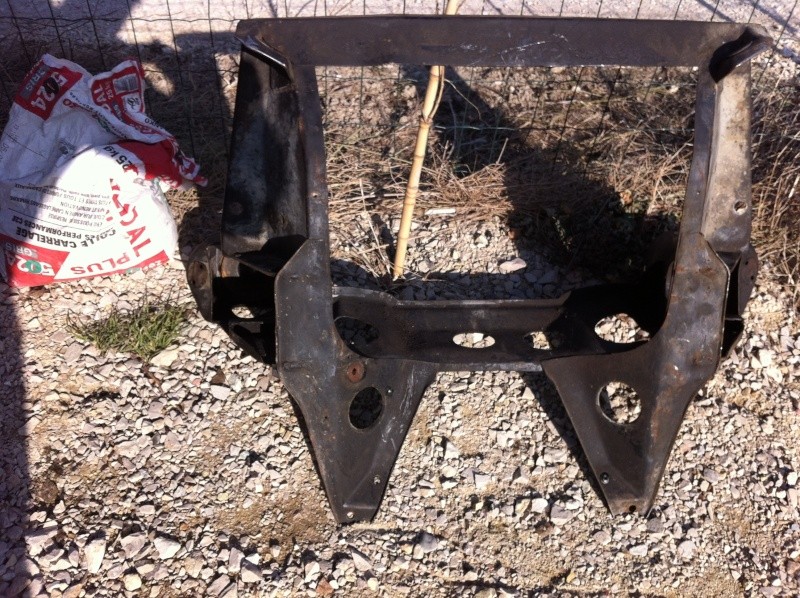

Front subframe, not too bad

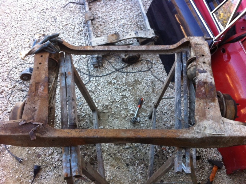

Now powder coated

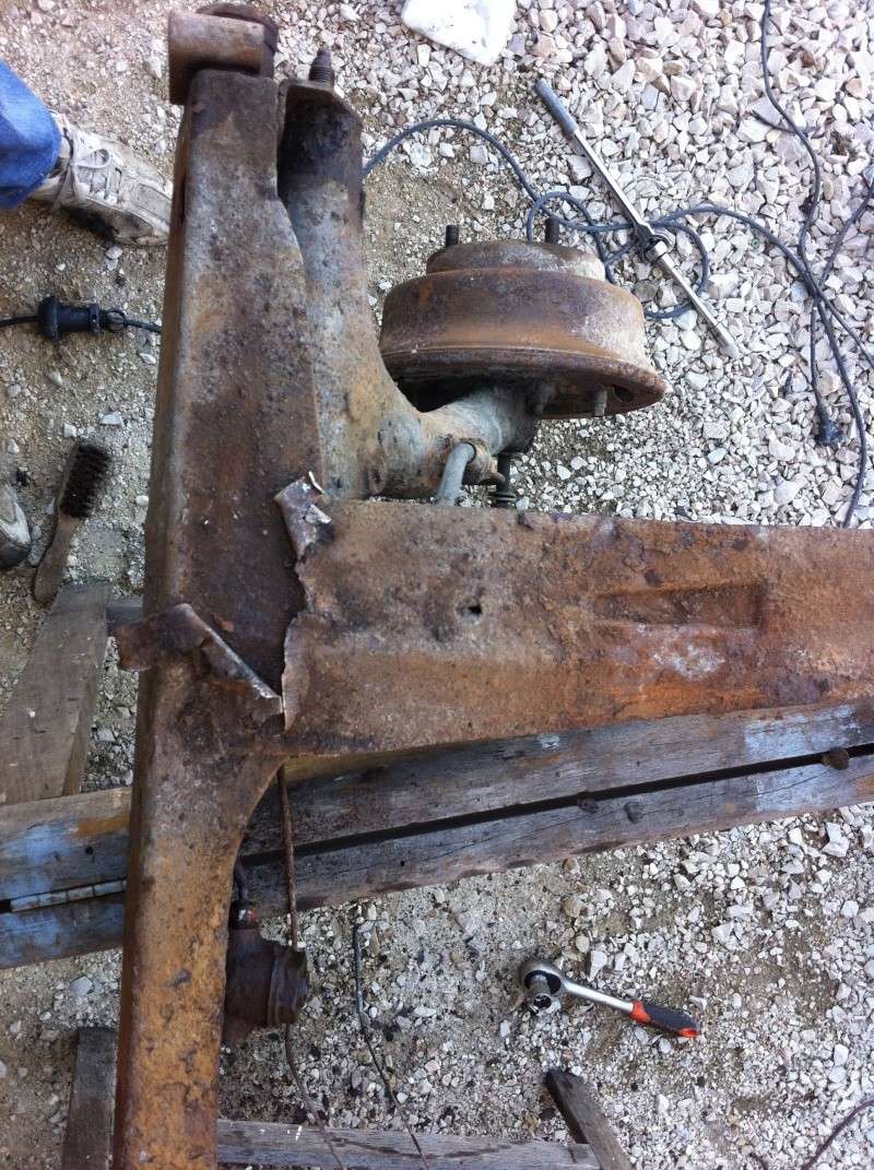

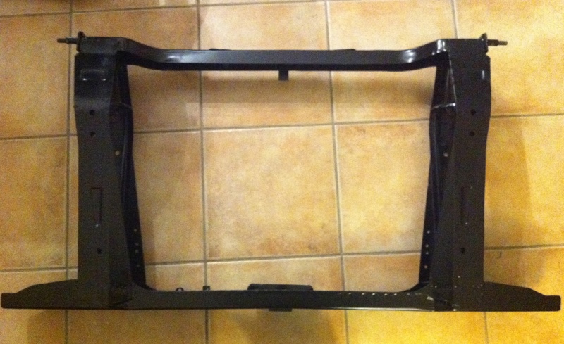

Rear subframe is...rusty!
So, found a new one, much better

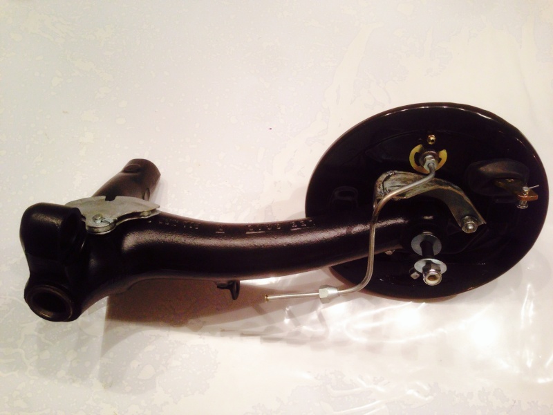

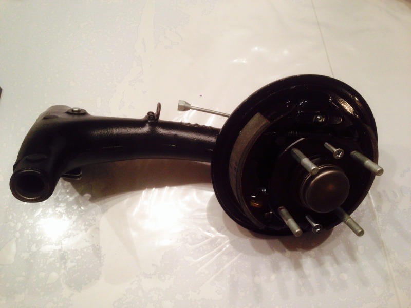

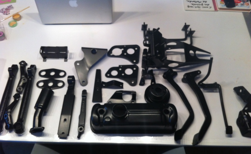

Back from powder coating, with some other parts
Rear arms, waiting to be fitted
And some other parts, back from being zinc plated

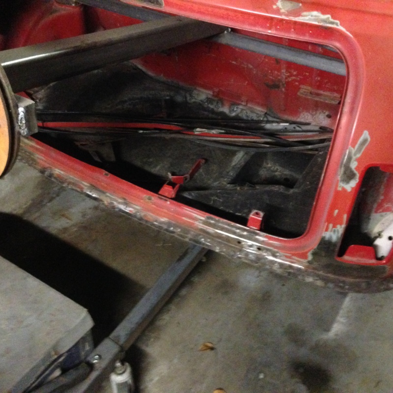

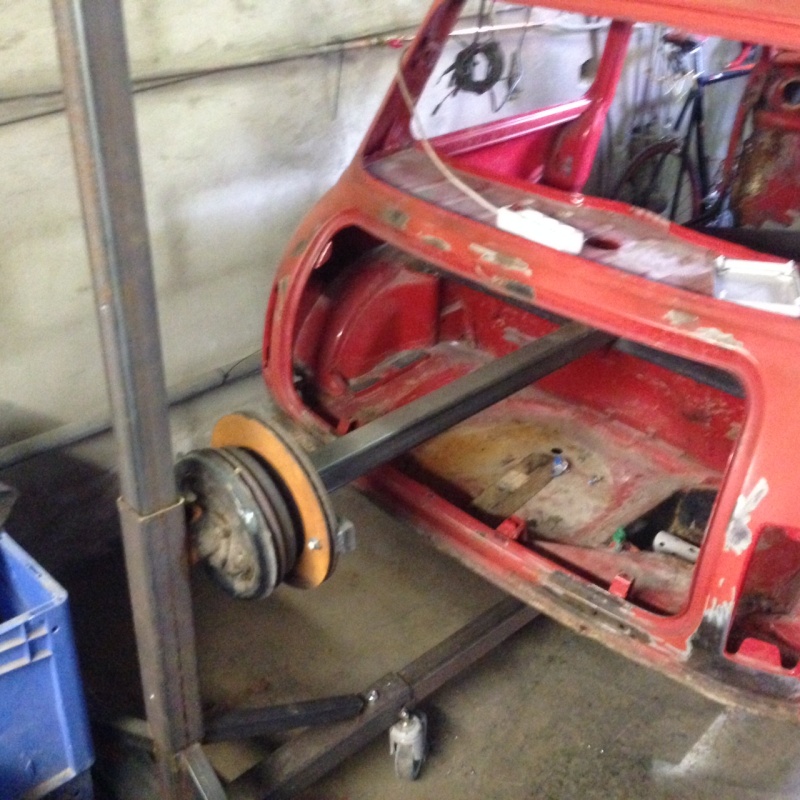

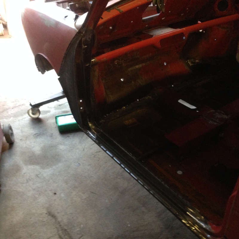

During this time some work done on the bodyshell ... more photos to follow

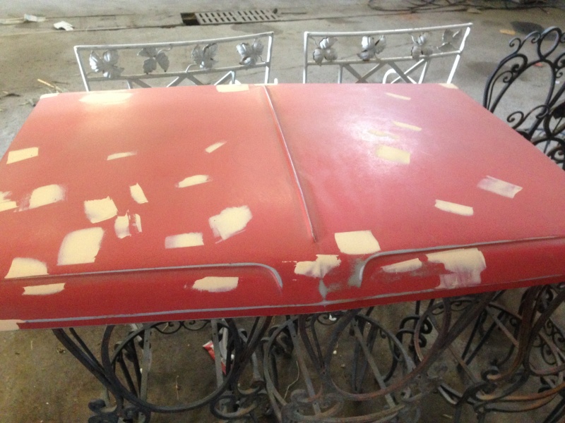

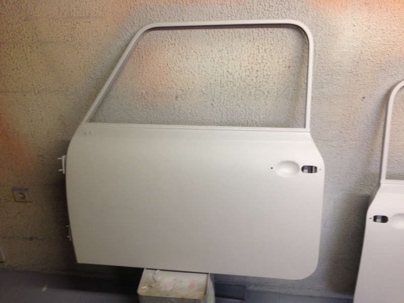

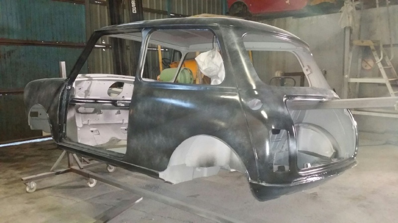

Thank you guys! Some more progress on the bodyshell:
During this time, I'll have to work on the engine!

The car has spent a lot of time in a field, without any protection... Perfect for rust installation! And you're right, my 1974 GT has 7.5 discs, boot board, servo, etc.

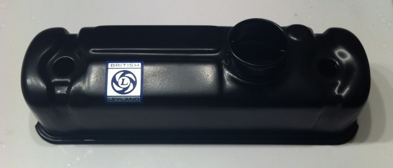

Now, it's time to bolt on new shiny parts!

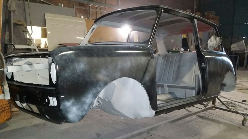

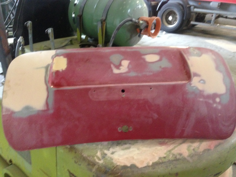

A bit of update
Underside has been done
And next step is... black roof! I know that roof must have the same colour as the body... but I love it black!
