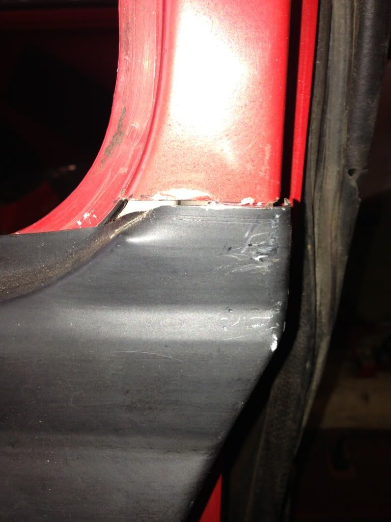

I'm in the process of fitting rear quarter panel, first day of fettling.
I have a gap between the lip on the panel and the B Post
XMrZNkk.jpg?3
The lip on the panel is good until the top 150mm  where it starts moving away at the top its about 5mm
Looking from inside the car into the lip on the panel
Whats the best way to fix this?
Slot the edge of the panel and move the lip over to the B Post?

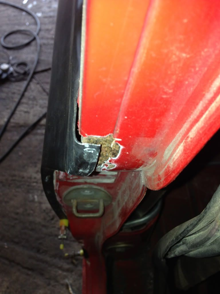

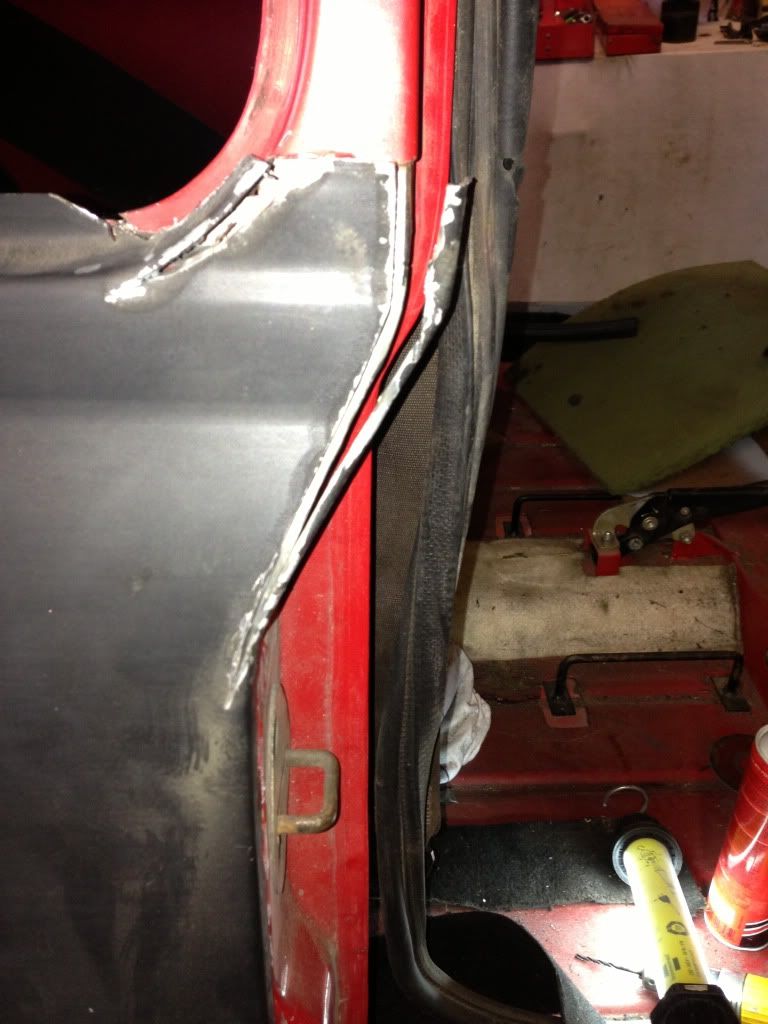

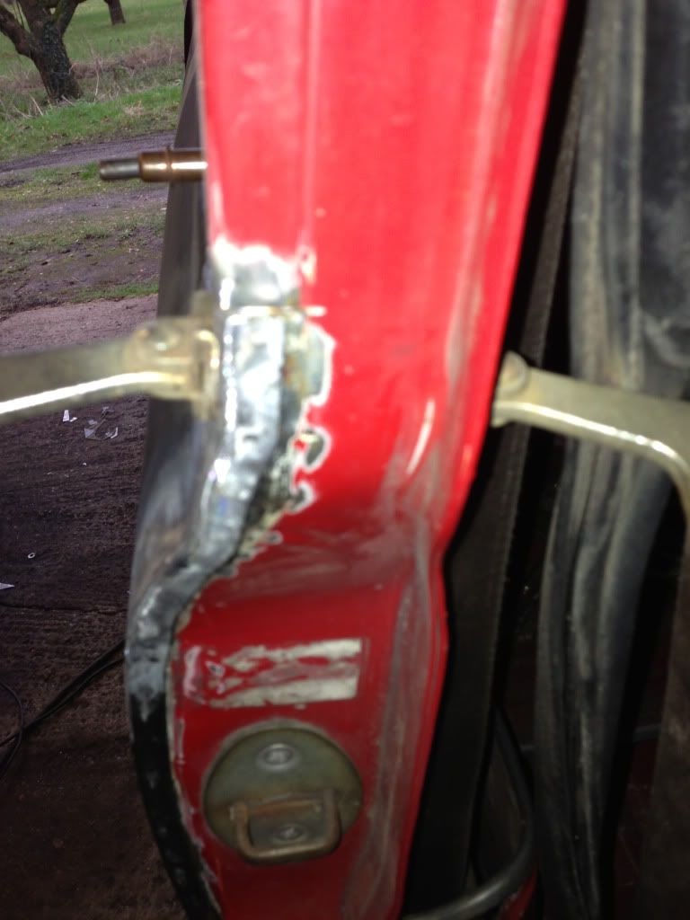

Ahh thats looks very familiar
b4ab700aee01f7a3e375758055383b9e5f85f022
2fa7abc7e6b48815c14c3b0e19b8d4d8e960c2e3
5099e7e18628918df99340b21dc7d0a9a7055e8b
1a027cde7310c8f3372abed8b9f918527f612ec1
9468ec3d23bcd8fa9a736237a7c4ccc35e36a75d
0ec09525ec7d49113fc0626f8181bf657b3a1958
Hopefully that will help you.

@Sonikk4 thanks, that’s what I thought would be required. Not sure my welding is up to panels that show.

38863a313587e3ce33fd5ebde2e23934b85d2e54
Take your time and it will work.
