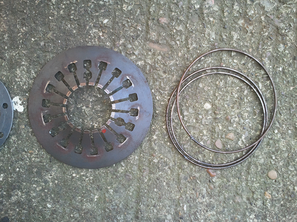

how am I supposed to pull the flywheel off now? :) by cutting the springs I guess, but still. strange problem :)

Posted 21 November 2019 - 11:02 PM
just remove the clutch plate and if needed re-align the bolt holes
#5 dotmatrix
dotmatrix
  • 441 posts
  • Location: Vejle
Posted 21 November 2019 - 11:22 PM
cant remove the clutch plate. I can loosen the flywheel but that wont help me.
what I can do is either drill out the rivets holding the clutch plate "fingers" or cut some of the fingers off where the puller bolts is goes

Posted 21 November 2019 - 11:26 PM
I would see if you can slip the fingers around with a drift and a hammer. They may have slipped.

Posted 22 November 2019 - 09:02 AM
Yes i will try this first.
its been a while since i removed my clutch, and i cant think how it all goes together, if you undid the clucth cover bolts(removeing the pressure) then you would be able to spin the clucth plate, re align and tighten up to then be able to pull the flywheel.

Posted 22 November 2019 - 09:39 AM
Looks like a Verto,Don't they all fit on the outside.As said take it off?Long time (4 years) since I did mine but I dimly remember cutting it to pieces for some reason.Good luck.Steve..
#10 nicklouse
nicklouse
  • 19,057 posts
  • Location: Not Yorkshire
Posted 22 November 2019 - 09:45 AM
nope bolted from the inside by bolts. the only options is if the finger ring has slipped and it will move back hit it. or cut away the fingers covering the holes if it was made incorrectly and then fitted with no concern.

Posted 22 November 2019 - 02:38 PM
Well thats interesting, as said you can try drifting the fingers round, but it looks like they need to go a fair way, I think the body hass been drilled/manufactured wrong. if you check the link below theres a pic of the spring that might help you visulize how its constructed. I think you'll need to resort to drilling off the 9 rivets that hold the spring so you can pull it, the rivits are fairlly soft so will drill ok, just centr punch them first and use an 8mm drill

Posted 22 November 2019 - 03:32 PM
http://www.turbomini...507494-4704.jpg
Thank you for the picture. Looking at that picture it does not look like drifting the fingers round will work.
I will try anyway. Also undoing the 6 bolts to take the pressure off
