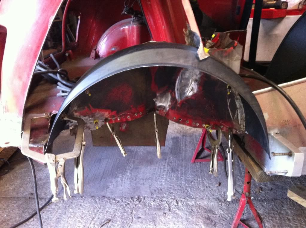

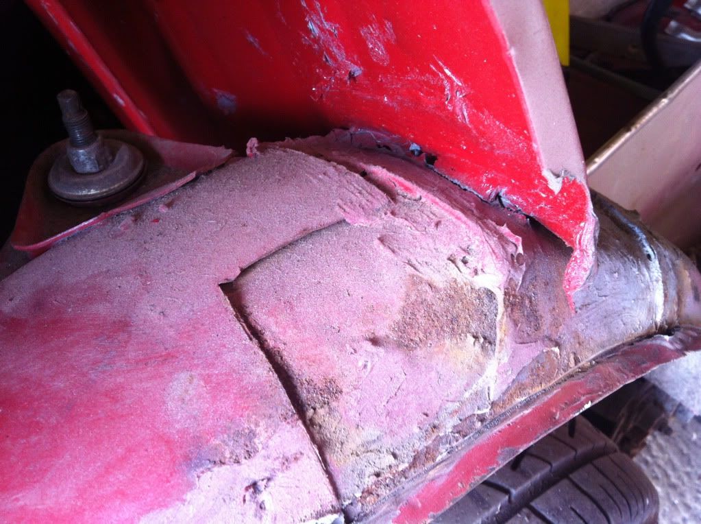

Below is the repair i did to my mates Cooper. This car was covered in repair patches and the arch was one of many. This is what i saved and it shows a lot of the spot welds that are hidden. The primary one is the bump stop which is a swine to get to. I used a Magnum half panel to replace the other section which looked like this before hand
1a320522766cc81685dfd05d2712267f0273e65c
7c50f3f17e23df37ab435e05d692994401308d90
New Magnum panel pinned in place along with the repaired inner section.
6c09cbd72843947ee3acfa7392e452a10e805914

Have parted the arch to quarter panel and made front and rear cuts across the top of the arch. Now its just the seam between the vertical (inner) wall of the arch and that repair panel as shown in your picture Sonikk4. Is that seam a continuous weld or spots? As I'm working at the very top I have the shocker reinforcement in the way so am coming at it from under the arch and not the boot. Am thinking I will need to slice the whole welded area off and weld a new flange back on - to which I can then attach the repair panel. Thoughts ?

Sorry I should have said it was roller spot welded on the Red Cooper. Pain in the backside.
