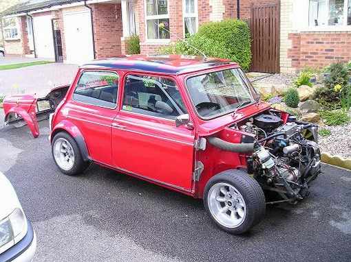

Carbon fibre, theres a guy called smudger has just finished making one at a reasonable price.
Heres mine: (not of smudger, mines a curley one)
#13
Posted 21 October 2004 - 09:59 PM
cool u have the apanels removable on ures. smart idea
