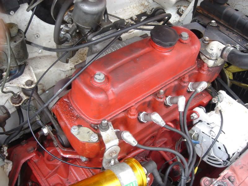

#6 mad4mins
mad4mins
  • 1,396 posts
  • Location: Andover
  • Local Club: WAMO!
Posted 06 October 2006 - 12:50 PM

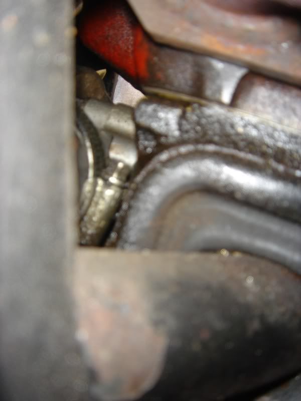

if you mean the really small rubber hose (2 inchs long), then they did block it off at the cylinder block..
not sure exactly which passages they blocked of sorry..
im not running a heater so they advised me to leave the thermostat out and block of the plate on top left of the cyl head...
http://i113.photobuc...ns/DSC02409.jpg
i tried to take some pictures of the blocked of hose but cant really get my camera in the gap..
http://i113.photobuc.../DSC02412x2.jpg

#7 Bill USN-1
Bill USN-1
  • 260 posts
Posted 06 October 2006 - 02:55 PM
Thanks.
It was the small hose I was referring to.
