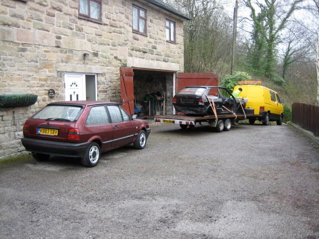

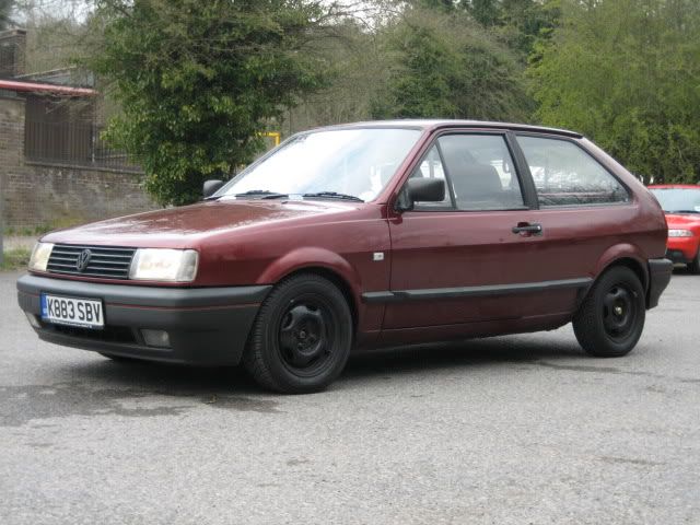

Anyway, the day after the crash I went out and bought this little beauty:
A completely standard, 1043cc 1992 Polo CL with just over 88k on the clock. I got it for a bit of a bargain and drove it home the same night (very slowly and keeping a good watch for idiot Jaguars in my mirrors! :w00t:)
Luckily I had been able to drive the black GT home after the accident, so I then had two Polo's and a Mini to find room for. I took the Mini to Dad's house so I had the garage free to do work on the black GT, getting it stripped of all its nice bits!
The first job was to get the CL onto some decent tyres, as it had 135 width ditchfinders on! I managed to get hold of some A539's very cheaply, so on they went with some GT steelies, already looking much better:
By this time I'd already swapped a lot of stuff from the GT, including the full interior, front bumper and cross member, foglights, rear lights and a few other bits and pieces.

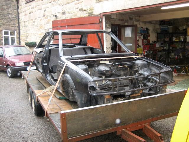

I ran the CL as it was for quite a few weeks until the start of April when I'd managed to book a week off work in order to do a spot of work on the Polo. Over the weeks I'd been stripping down the GT until it was ready to go to the scrapyard....bye bye GT!

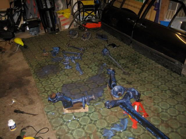

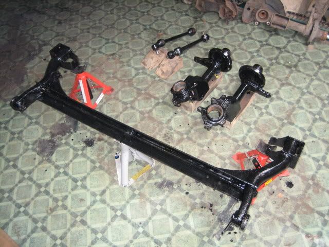

The first thing to do was to recondition all the parts from the old GT which were going on the CL, which included the rear axle, front struts, brake carriers, and lots of other things - out came the kurust and black paint:

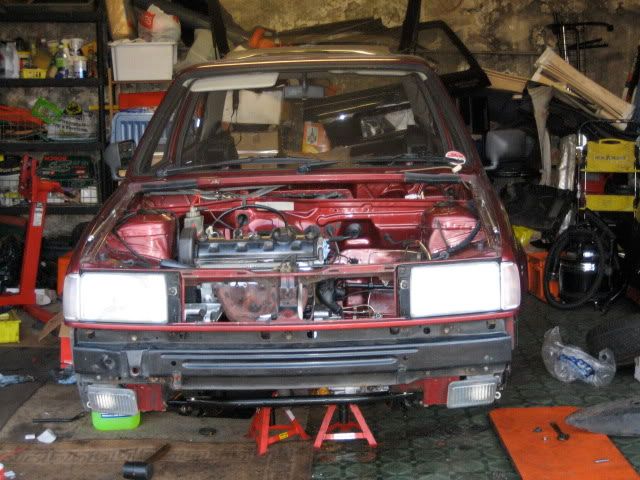

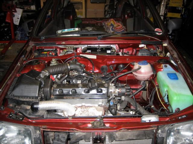

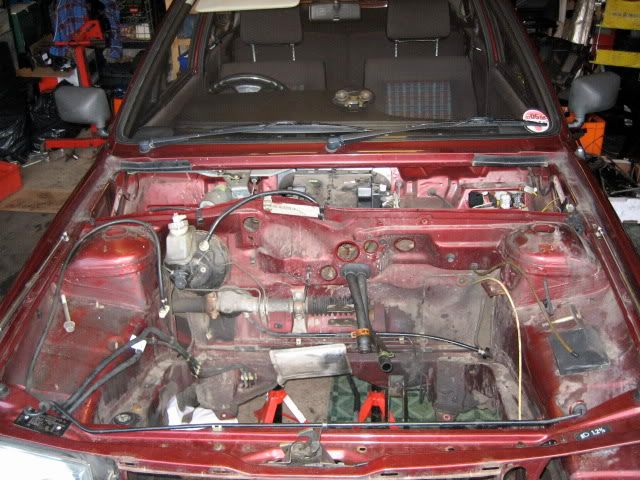

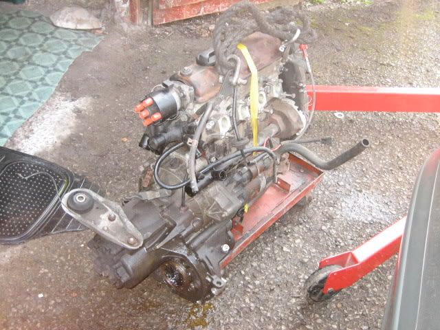

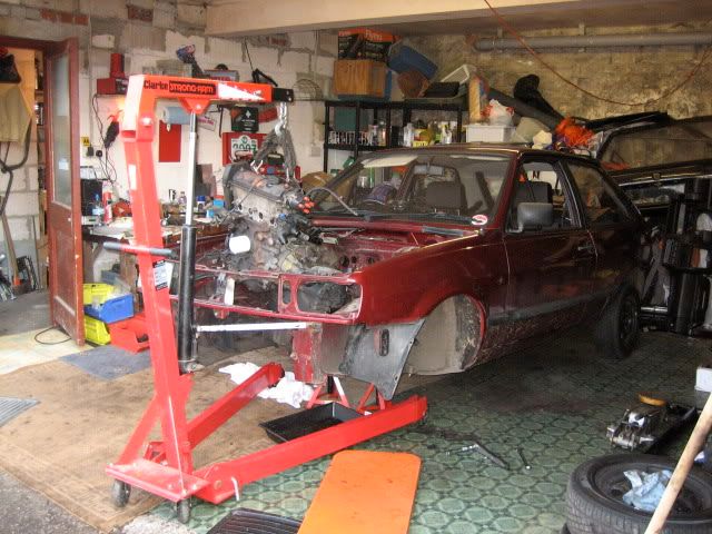

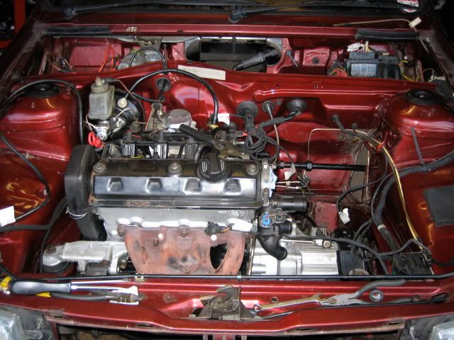

Then I yoinked the engine out of the CL:

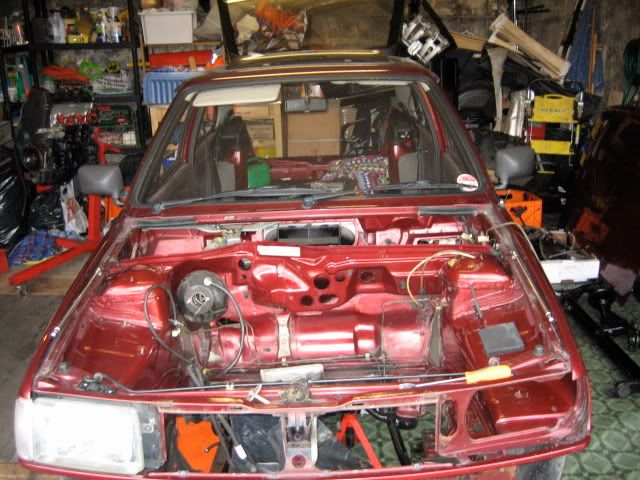

And got the engine bay cleaned up, from this:
To this :D

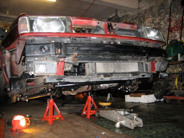

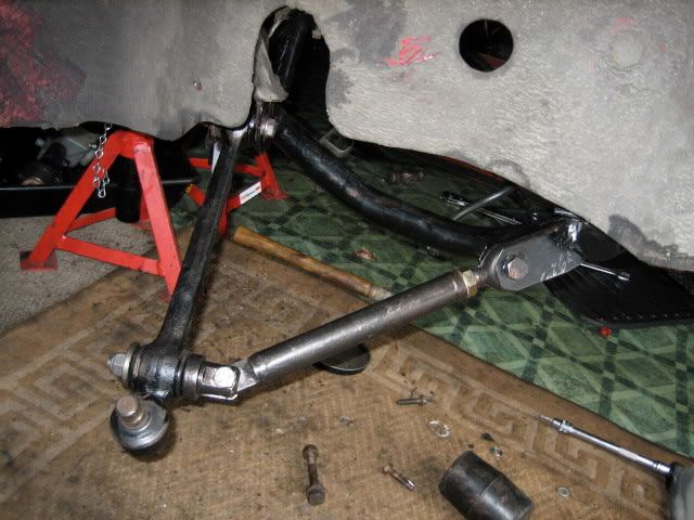

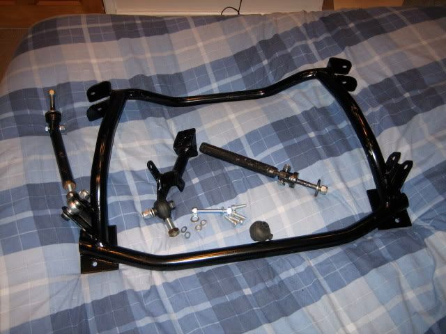

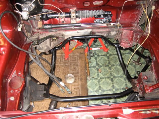

Once that was done it was time to fit the front subframe. The Polo probably has the crappiest suspension design as standard, ever. It has track control arms, which are similar to a Mini's bottom arm, but rather than having tie-rods like a Mini, it has what is optimistically called an 'anti-roll bar', but which I think should be called a 'poor-attempt-to-hold-it-all-together-bar'. The 'pathiat' bar's job is to not only prevent the front end of the car from rolling all over the place, but also to control the castor and camber of the front wheels, as well as holding the lot together under cornering and when accelerating/braking. It does this by being mounted to the car in only two places, held in place by large soft rubber bushes, which do nothing but wear and you end up with awful front end handling. Polo's with this design aren't particularly nice to drive unless some work has been done to stiffen the front end up with brace bars and poly-bushes, but even then they still suffer with changing geometry when cornering and general crappy-floppiness.
The subframe conversion basically gets rid of all of that and uses the TCA's, along with a Mini style tie-rod, giving you a lower wishbone assembly - hey presto, great handling :w00t:
Here it is:

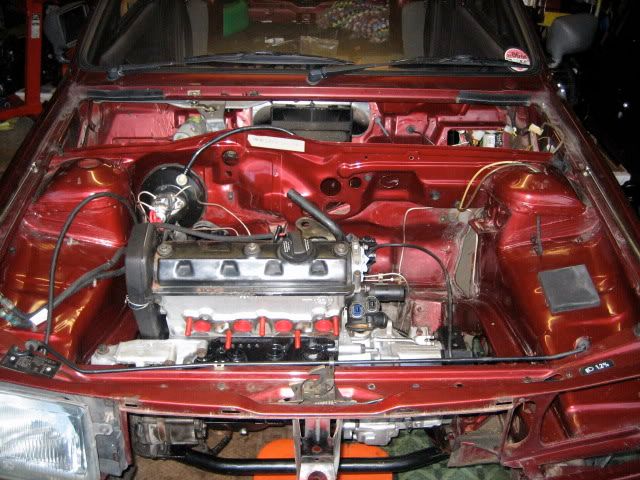

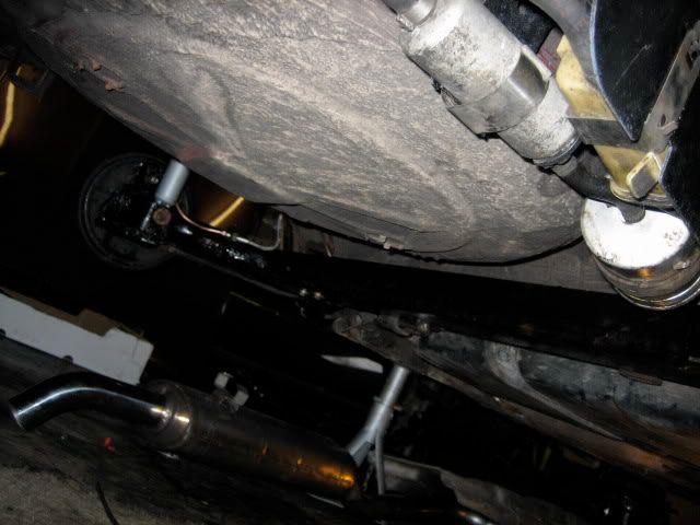

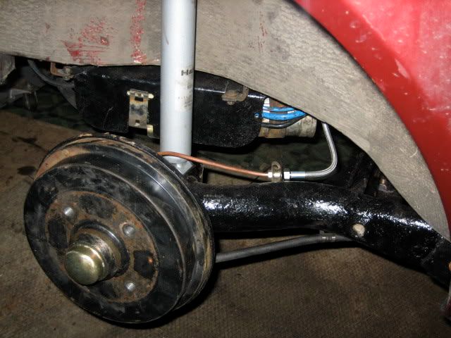

As well as fitting the front subframe, I'd also been fitting the GT fuel pumps (needed to feed the Golf engine), as well as the GT rear beam and previously-reconditioned brakes, plus new brake lines throughout and the braided hoses:

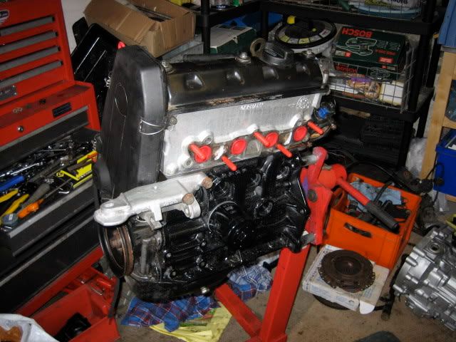

Also, as well as doing all of that, I'd been reconditioning the head for the new engine, with new stem seals and re-lapped valves. The engine was coming together nicely, with a GT camshaft for good measure. The ABD engine is essentially the same lump as the previous 1272cc 3F GT engine, albeit with a bigger bore and slightly lower compression ratio (9.5:1 as opposed to 10:1). This slight loss of compression is more than made up for by the extra displacement, and coupled with a GT camshaft and GT management you end up with a really nice torquey, economical engine:

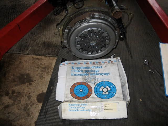

I fitted the genuine VW clutch (eBay bargain!) and the gearbox, then dropped the engine back into the car:

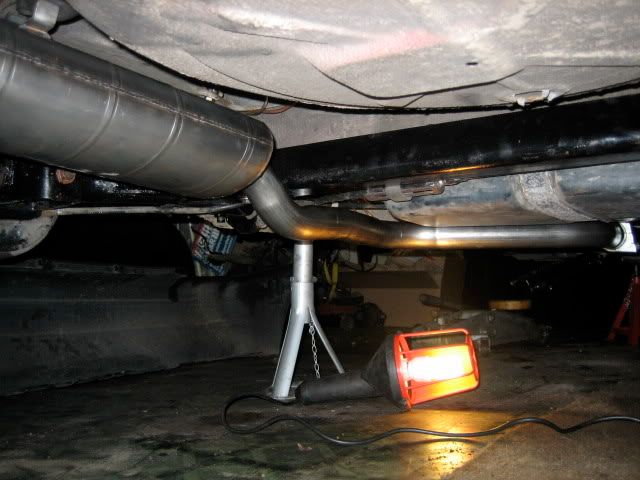

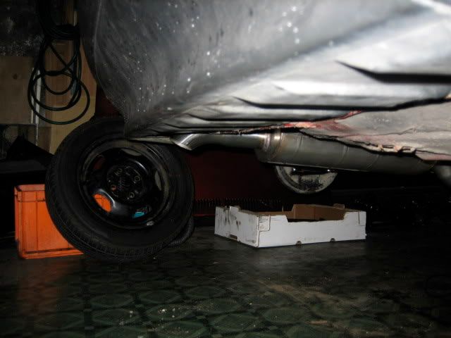

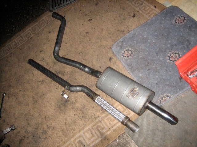

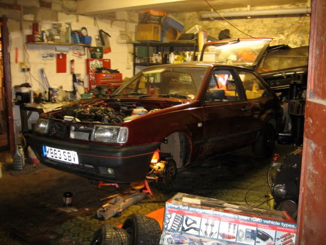

It all fitted a treat and I was ready to put things back on. While doing the rest of the work I'd had a custom exhaust made up for the car by a local stainless specialist. Its a 2" full system in stainless, single box, with a nice hidden TDi-style tailpipe, which comes out nicely just behind the rear bumper. I much prefer this as its nice and subtle, and Mk3 Polo's look much better with a hidden exhaust in my opinion. I'd done some research into exhaust and the 2" system would benefit the Golf engine greatly, hopefully releasing a bit of extra torque without affecting economy:

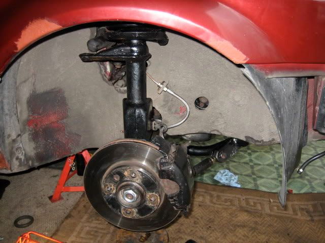

Then it was time to refit the front suspension, along with new wheel bearings, springs/shocks and the G40 brakes:
Then it all started to come back together very quickly:
