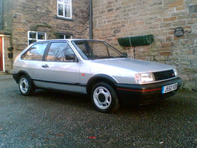

Guess I should start a project for this, been as though its becoming a bit more than just a daily driver now!
Model: 1991 VW Polo GT
Engine: 1272cc 3F engine, completely standard, 126k
Suspension:
Standard height, right hand rear shock saggy!
Brakes:
G40 VWII Calipers with 239mm vented discs
Wheels and Tyres:
13x5.5" G40 BBS RA wheels, with 185/60R13 Yokohama A539's
Exterior Styling:
Clear front indicators, late-spec tinted rear lights, G40 type bee-sting aerial, wing mount blanked off
Interior Styling:
Low milage interior from a late GT, black carpets, standard steering wheel, cooling fan switch on second demister switch, rear seat belt guides, boot side carpets, fire extinguisher on a bracket in the boot, OEM VW floor mats. Uncut parcel shelf.
ICE and Security:
Alpine flip-front head unit, JBL GTO 8.5cm speakers front, 6x4 speakers rear, in correct locations.
Comments:

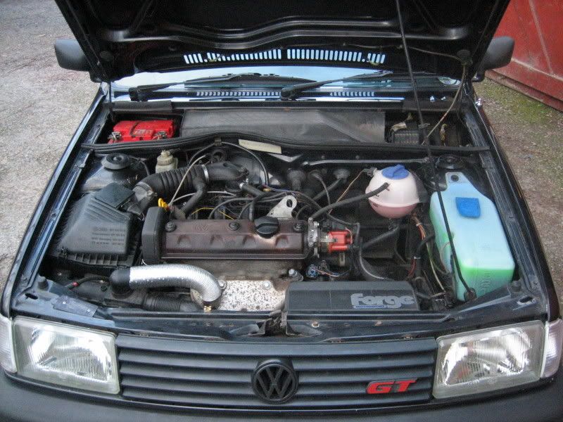

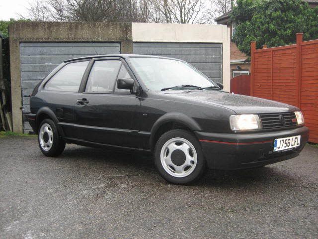

Where do I start? I bought this car back in September after selling my original GT, I wanted another one! It seemed like I got a good deal at the time, but to be honest the car was really suffering with engine faults and loads of other problems, but I got it home and started work. There's loads of my posts asking about problems and slowly but surely getting them sorted, so its all good, now its running the best it ever has, I regularly get 44mpg, and it pulls really well!
But the engine is starting to suffer, its got chronic piston-slap in the mid range when not under power, so its coming out soon, to be replaced with a low milage ABD engine I procured from a Mk3 Golf. I'm just rebuilding the ABD so in a month or so the 3F lump is coming out, either to be rebuilt and sold or sold as it is.
Got loads of other things sat in the garage waiting to go on too, a set of VWII calipers with new discs and Raicam fast road pads and just ordered a G-laderseite polybush kit for the front and rear to tighten up the handling. While the engine's out I'll be fitting PSD braided hoses all round, and be giving the engine bay a bit of a clean up. I've got some original 13x5.5 G40 BBS wheels for it, with brand new A539's, they'll be going on at the same time. Also I want to improve the suspension, but I'm not so sure what to do there. I'll be dropping it 40mm, but how I don't know yet, still got to decide! At some point I'll be getting some pressed steel number plates, and I want some clear side repeaters eventually (I took the crappy black ones off in the pic and put the orange ones back on).
Once I've got the running gear sorted then I need to sort out the bodywork! There's a couple of very small rust patches, one on the bootlid and one the bottom of the drivers door. There's also a lot of small parking dings which are really annoying me. There's also a dent in the rear hatch where a door blew open into it. Ideally I want to have it fully re-sprayed and sorted out, but I don't think funds will allow me to do that just yet!
I'll also be fitting a central locking kit, and a decent alarm, with Mk2 Golf rear door handles. I've already got the handles converted to Polo plungers so its just a case of fitting the locking kit and its done. Oh yeah, I also want to get some Mk3 fogs too, I've already ran the wiring to the front, just need to get some fogs to plug in!
Think thats about it, sorry for the essay! Here's some pics:
And just for the record, here's my old GT:
Oh, and here's a couple of arty farty (ish!) pics I took of the Mini and Polo together not long ago:

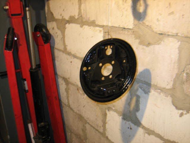

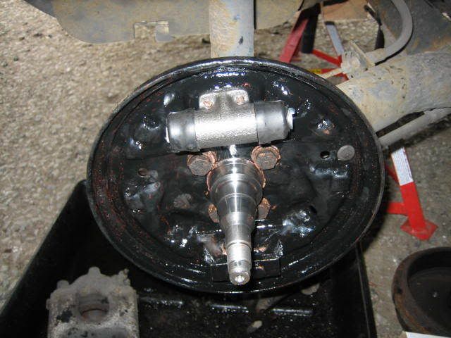

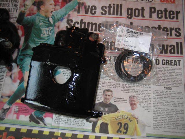

Did a little bit more on it yesterday! I'll let the pictures do the talking:
New drums, stub axles, discs, VWII calipers, pads, shoes, wheel cylinders and wheel bearings:
Genuine VW caliper rebuild kit :-
Discs and calipers on (braided hoses to follow but PSD were out of stock:

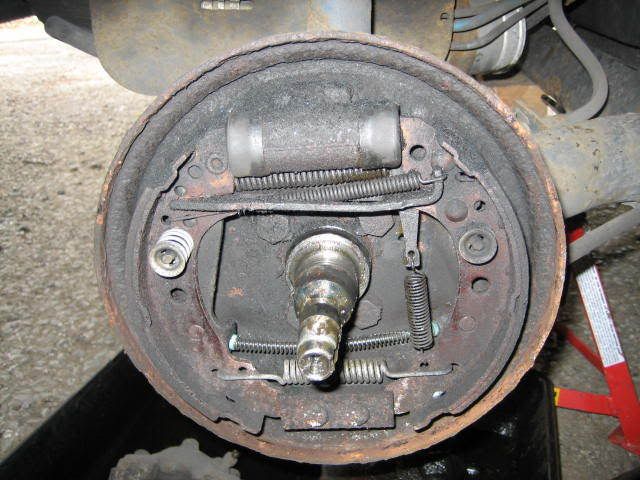

Minging old rear wheel assembly with knackered bearings, leaky wheel cylinders and contaminated shoes:
Shiny new backplates, wheel cylinders and stub axles:
Fully rebuilt:

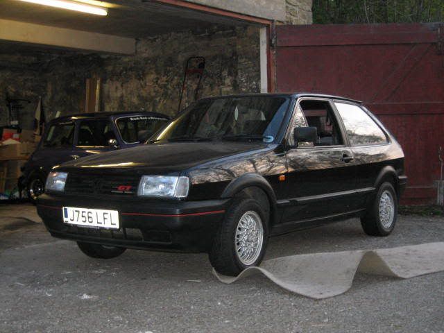

Back on the floor with G40 BBS (sorry about the carpet!)
Just need to get the ABD engine in, sort out the suspension (going down 60/40) and give it a good wash!
