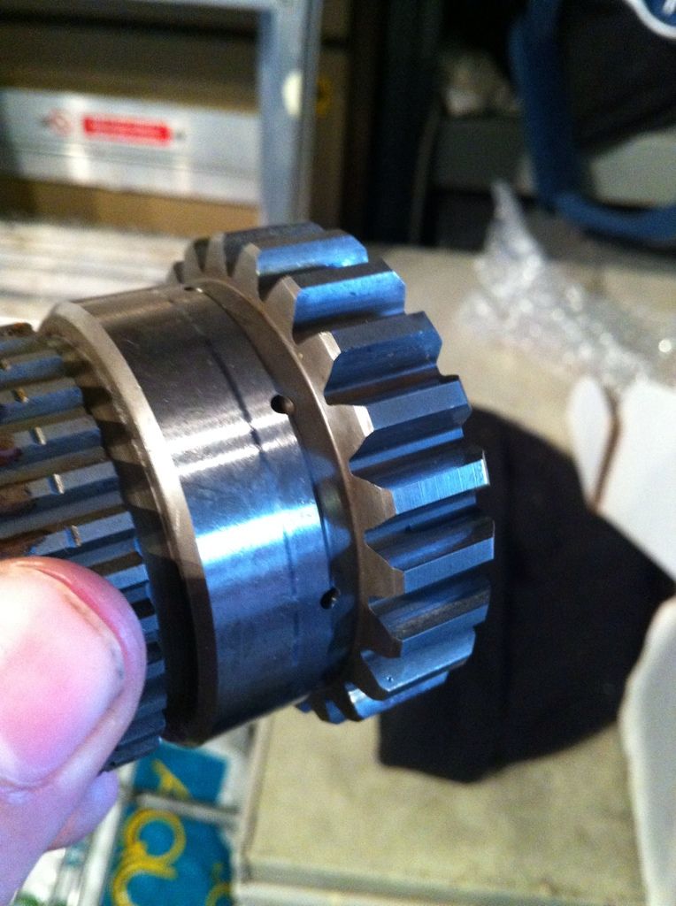

After doing a bit of reading, I've found out these are A series straight cut gears.
0B89438E-0135-4F49-8E12-2F7C105757C6-163
E8CF4160-F6DF-4182-B87B-C1E9B35A494B-163
20108B7A-6B73-495C-842A-59113EE92C43-163
WRONG THREAD SORRY!
