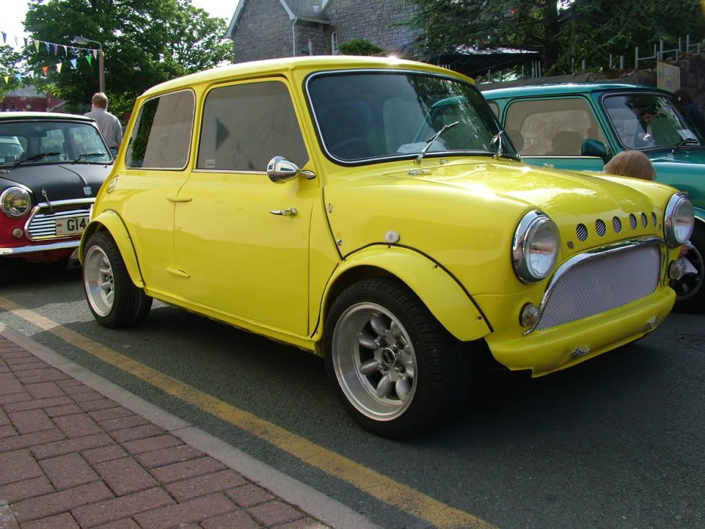

Was looking at rally mini's and found the yellow one with suicide doors. This was the only picture there was of it

#15 ginger_monkey
ginger_monkey
  • 1,080 posts
Posted 31 May 2010 - 01:31 PM
Think I'd have to put solenoids on and no handles as that first yellow one just looks a little out of place with the handle just sat there. Love the hinges at the back though >_<
