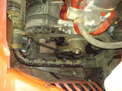

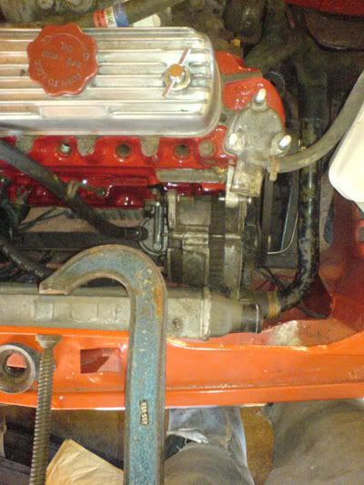

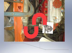

Righty - I've got to the stage of fitting out my engine bay with all the cooling hoses and radiator and I'm after some information to help me proceed.
I've bought a Mk1 metro rad (with the inlet and outlet on the same end) and I plan to have a metro header tank and associated hoses, all cut down to suit.
After playing with all the above at the weekend it's clear that everything will fit but I'd like to see how other people have done this before I go chopping things about.
So - anyone got any advice or more importantly PHOTOS of previous installations! I've trawled for a while using the search but not found what I'm after.
Also I have one issue with fitting it all - the top hose looks like it's going to be a really awkward shape - see image below. I realise the rad needs to sit further forward under the slam panel but it still looks like the top hose will be an awkward shape. Any ideas on what hose is best to use here (custom hose/chopped down metro hose)? I really want to see what people have used in the past to get round this problem...........
Posted Image Posted Image
Cheers,
Mart :thumbsup:

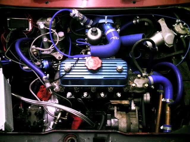

#2 mini_mission
mini_mission
  • 442 posts
  • Local Club: bumpstart
Posted 16 October 2007 - 05:32 PM
this is mine, however i have used a mk2 metrot rad- think it was made between '82 and 89
hope its of some help
have you tried using the thermostat housing of a side mounted rad mini? might lessen the angle a bit?

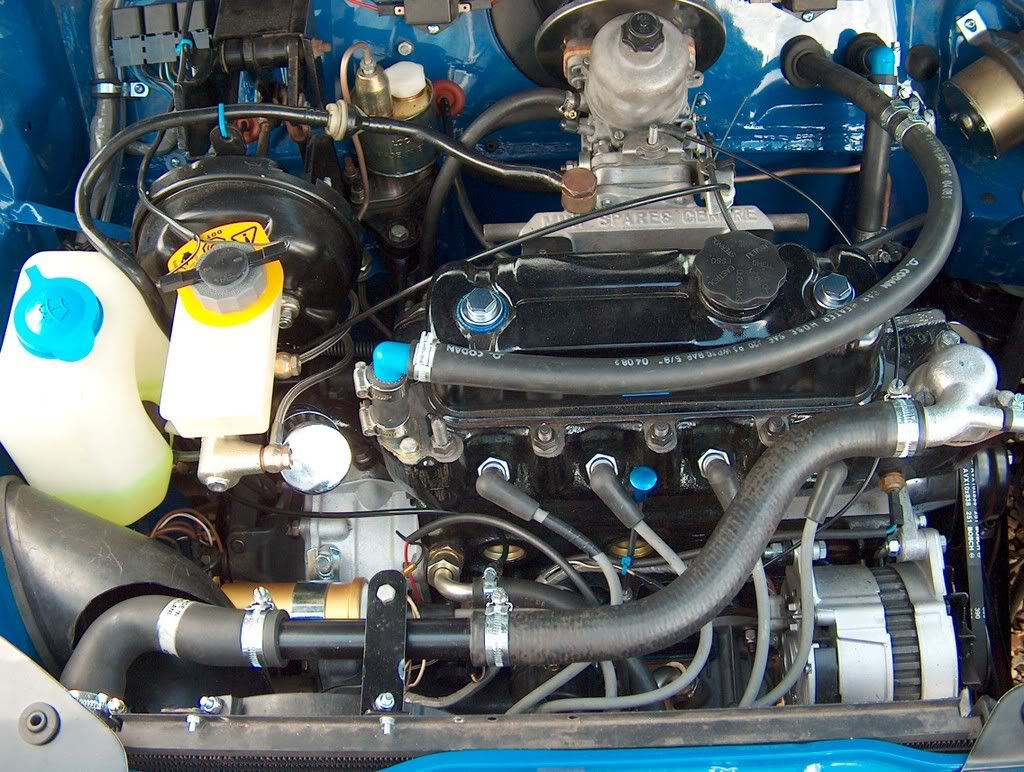

I also used the Mk2 rad as it was thinner. The thermostat housing is a MPi one, the top hose off the rad is a 1275 SPi one and the curved hose is off some obscure classic - I have the part number scrawled on my parent's garage wall! My bottom hose is done almost exactly the same as yours, but I have a take-off welded into the metal part of it to go up to the bottom outlet of the header tank. Here's a pic:

#4 sherly
sherly
  • 704 posts
  • Location: Saaaa'fend
Posted 17 October 2007 - 09:12 AM
A couple of cracking engine bay pics cheers guys. Mine will look that clean when complete (the bits in the photographs are "scrapyard fresh" :thumbsup: )
It does lead me to one question though - has anyone actually used a Mk1 Metro rad or have I just gone and bought the wrong type to fit to a mini?
@ mini_mission - I have thought of using a different thermostat housing as the metro one does seem to be cranked over more than a std mini one. Problem I have is that I need a take off for the expansion bottle. I guess this is something I could have tig-welded on and machined up though......
@ jayare - The thermostat housing on your car looks promising - especially if turned through 120deg as it would put the outlet stub further across (towards the passenger side of the car) and pointing at the front of the car (and it has the expansion tank stub too)
Anyone else got any ideas?

Posted 17 October 2007 - 09:40 AM
Mini & Metro hoses are different bores
1.3 Maestro/ Montego might suit you also
I have a spare, brand new, MPI injection stat housing.
don't bother with tig
http://www.theminifo...hl=clever ethel

Posted 17 October 2007 - 11:18 AM
@ Ethel - that durafix stuff looks great! Have to get some and have a play......

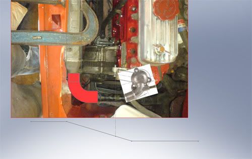

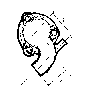

Any chance you (or anyone for that matter) could bung me a couple of quick measurements from the MPI housing - see image below - and if it looks like it'll fit d'ya fancy selling it?

Posted 18 October 2007 - 11:14 AM
Right - looks like I have a couple of options then. I've sourced an MPI 'stat housing (cheers Ethel!) and I reckon that I can fit it in the standard orientation and then connect two samco u-bends to create an s-shaped bend. The misalignment will be taken out once I've trimmed the front panels to allow the rad to sit further forward. Hopefully I'll be able to use socket cap head bolts to get around the problem of the change from 1/2" to 7/16" fixings too.
I'm also going to the scrappy on Sat to get a Mk2 metro rad as well just in case the above doesn't pan out.

#14 sherly
sherly
  • 704 posts
Posted 30 November 2007 - 01:29 PM
Just to add some closure to this question (for those searching who may come up against the same issues in the future).
Metro radiator has been mounted with custom brackets holding the rubber top-hat bushes - the top hose issue was solved by using an MPI thermostat housing (cheers ethel ;D) rotated thru 120deg (with the holes drilled out slightly larger). This puts the stub in the right position to use a standard metro top rad hose (slightly trimmed down). The only slightly bodgy bit of this is that the metro hose is a larger dia than the stub pipe but this difference doesn't seem to cause any issues when the hose clamp is tightened up.
The MPI 'stat housing needed some socket cap head screws to hold it down because it's impossible to fit a standard 1/2" AF nut onto a stud in one of the positions due to the shape of the 'stat casting (MPI bolts are 7/16"AF and longer to accomodate the spacer plate so are no good.)
Rad sits a little close to the dizzy (about 15-20mm clearance) but the bodywork could be cut more to allow the rad to sit further forward if need be. I havent bothered as I will be upgrading to megajolt after the car is MOTd.
Mart :)
