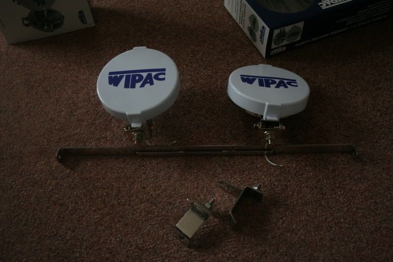

Bought 4 spotlgihts and a bar from huddersfield mini spares...
I assume the first two go on like this

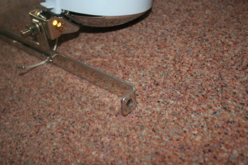

But, what am I meant to do with these holes here
Anyone have any idea? Cheers :lol:

The holes on the end of the bar fit to the bolts on the side of the lamp where they swivel, the 2 brackets fit to the bottom of the outer lamps then to the body !

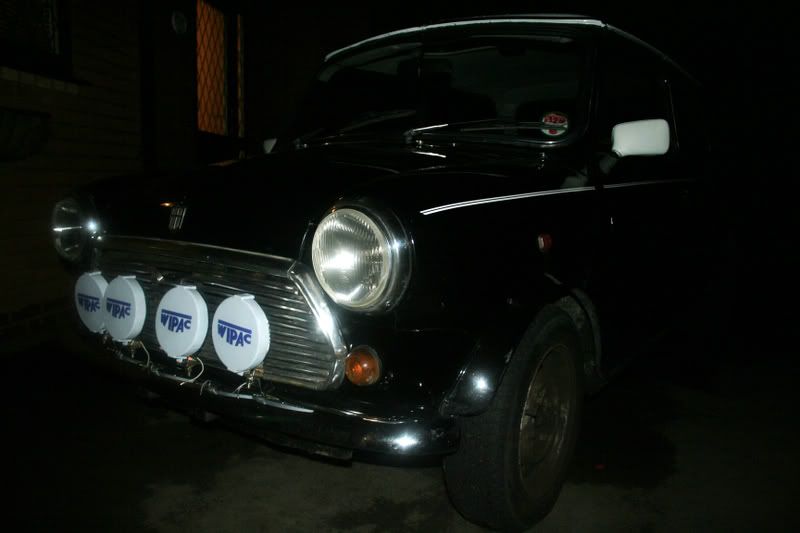

I cabled tied mine onto the metal behind the grilled which reduced the amount of wobbling significantly.
Here's them fitted:

Yep eventually :-
Had to drill the holes myself though...werent too bad in the end :cry:

that dont look right to me !!!
the bar should fit between the ends of the bolts on the outer two spotlights, the actual lights themselves, giving a two up/ two down pattern
#15 GraemeC
GraemeC
  • 7,439 posts
  • Location: Carnforth
Posted 30 October 2008 - 10:21 AM
Turn the bar the other way up (so the ends point upwards) and you will get the four in a line configuration.
