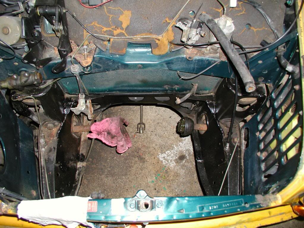

I have a 1990 Mini Cooper. dont appear to have much rust, I did replace the rear subframe and found no rust on the body, so a coat of waxoyl and refit the subframe.
At the front end I changed the brakes for Metro 4 pots and added Hi lows (well Msports copy) which I had laying around from a mini I broke up as was the rear subframe.

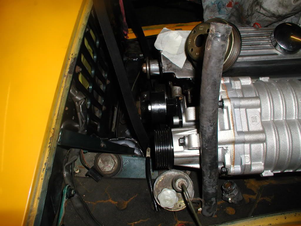

The pulley:
I have taken a Cooper S pulley this will run the alt and water pump I have machined it so that it mates to the MPI pulley.
the MPI pulley had to be machined down on the inside to lose the lip and one row of V, when fitted together the Cooper pulley stops the belt from wandering.
Now all I have to do is fit the 36 tooth pick up. and then I will do some pictures.

cheers Stig, I had to sleave each wheel so that they both have room on the end of the crank, it all lines up now so I am happy.

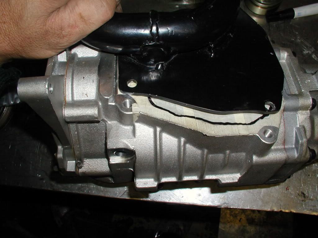

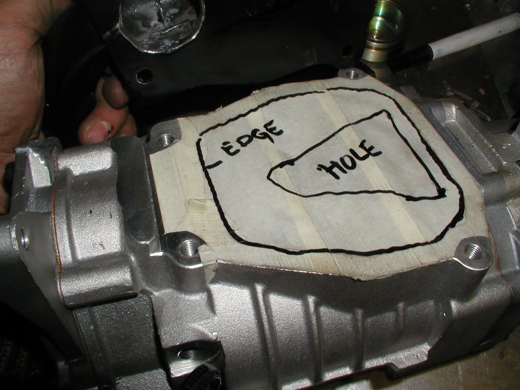

Looking at the manifold and the eaton you can see that the inlet hole is covered half way! what a load of scrap metal.
I am going to have to doctor the hole some what. i am going to move it over.

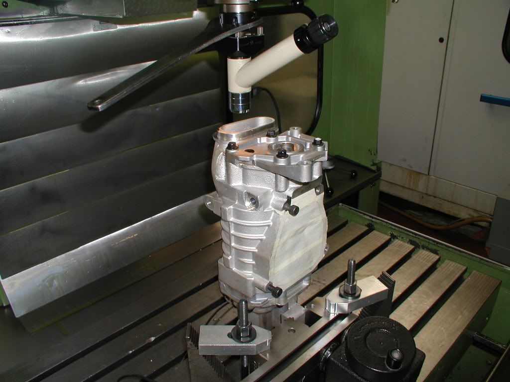

you have to modifie the supercharger as shown both jonspeed ans v scart max kit require this mod
as for the carb being out side the bonnett what the hell the carb should be a tight fit but thats stupid
the carbs on both my vmax and jonspeed kits where just above the clutch housing and you could just fit a airfilter in there
