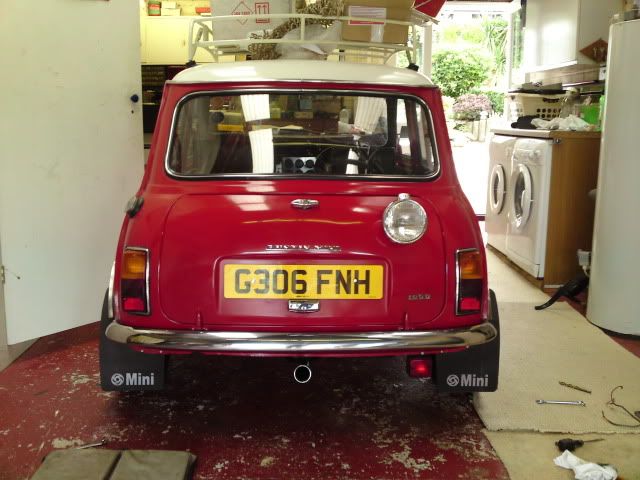

We just bought a '77 1100 special wich we want to give a retro rally look.
Now we just love those big reverse lights on the bootlid.
Are there any special lamps for this purpose? Or will a standard Mini front spot light
do the trick? in terms of looks that is...
If anyone can post or link some pictures, that would be great, to see what different
type of lights look like on the car.
Thanks in advance

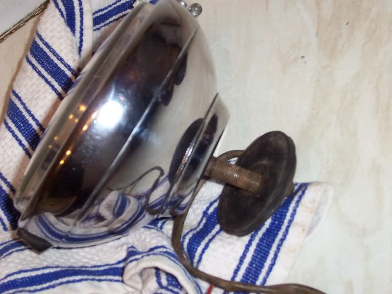

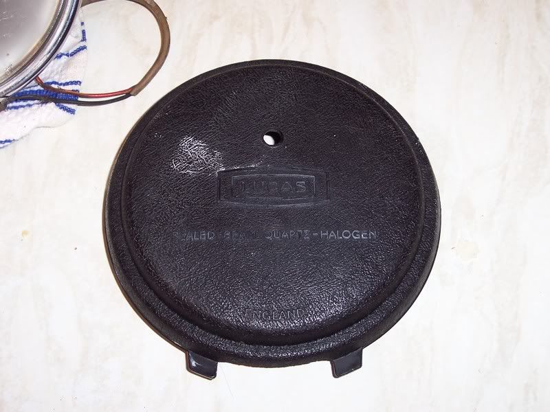

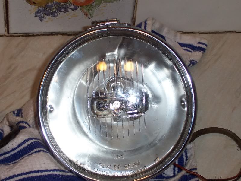

I'm selling mine, It's Lucas but unsure of the model. VGC.
Edited by Pooky, 14 March 2010 - 10:54 AM.

The flush fitting fog lights as used by the 'works' and private owned rally cars in the 60's and 70's were Lucas part number WFT576. That is not the same as the lamp in the photograph posted.
You can buy a very good new replica from Stafford Vehicle Components, www.s-v-c.co.uk for £65, same part number.
The part number sl576 is the long-range base-mounted spot light version, but plain lens and not suitable as a reverse light.
