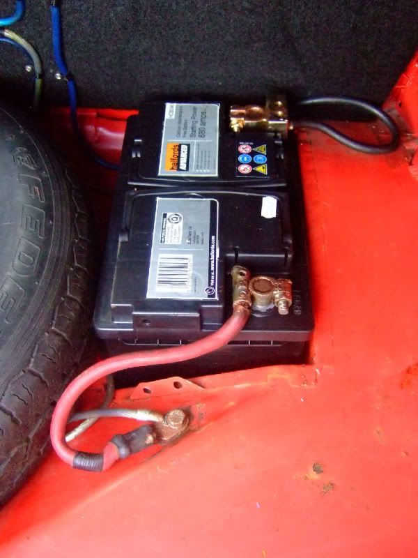

I squeezed an 096 battery into my Minis battery box. Overkill? Yes. Do I care? Hehe no!
Tha does look snuggly though, i'll have to remember that when my current battery dies!
Deff worth getting bigger next time i need one then esp once amp and sub are in!
Is this picture right i thought lead at bottom be earth but its red? lol on mine its earth and black top lead is +?
