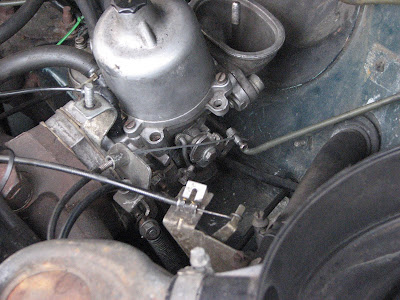

The first problem is when it's cold out, below 50 deg F, the car runs roughly until it's warmed up. I don't have a haynes manuel for this car yet, but I believe the choke on the carburetor is not functioning correctly. I looked at the carb, and it's a strange beast (I'm mechanically familiar with air cooled VWs mostly). I can't identify a choke on the carb. Can someone point me to details on the carb and how to adjust/rebuild it and set the choke? I see two cables going to the carb, one is the throttle I know, not sure what the other is for.

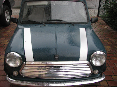

The car in question:

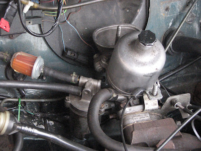

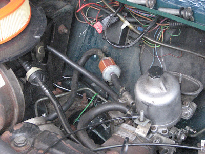

The carb:

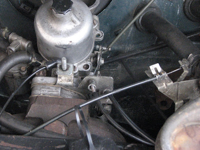

This picture shows the two fuel lines going to the float bowl on the side of the carb. One line is in. The second line is out from the bowl and the other end doesn't connect to anything (would drain onto the engine or ground). Is this normal (would seem to be a fire hazard):

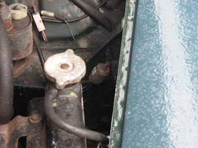

Is this the windshield washer pump? It doesn't work if so, and where can I get a replacement plus washer bottle?

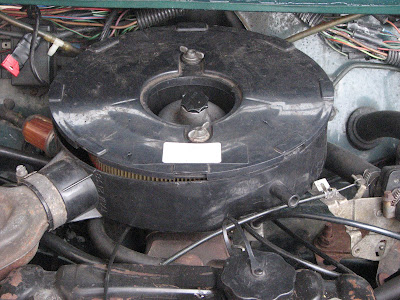

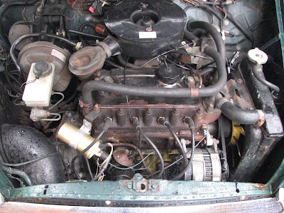

You can't tell it in this picture, but the plastic breather/filter box has a gap all the way around. What is wrong with it?

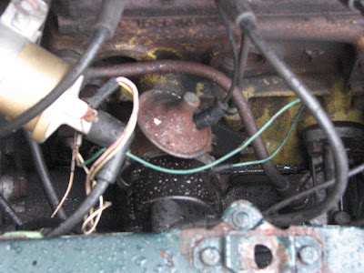

The distributor:
Entire engine compartment

The air filter the black thing with the gap, looks like its not clipped together properley, clip it together then fit to the car. Wants sorting it maybe the cause of your weak running you mention, weak running can also cause overheating. Which maybe another one of your problems
The choke is the cable on the left (right side of carb), the knob that controls it is the one on the left inside the car (I'm assuming left hand drive cars the dash is the same )
You need to keep adjusting the choke until the engine is warmed up enough not to need it, usually within 5 or 10 minutes of driving.
The pipe going nowhere on the carb, is an overflow, breather, top of the clutch housing should be a rigid metal pipe, it should plug into this, that rigid pipe just feeds down so any spilled fuel goes on the ground.
Can't actually see your windscreen washer bottle, but on UK models its to the left of the brake master cylinder/servo, pump is built into the bottle on that age.
Your dizzy looks a bit dirty and looks like its got damp on, good idea to clean that and the leads, and buy or make a weather shield to keep it clean and dry.

Since you are unsure of the age of the ignition components, start with a general, complete tune up. Set the valves cold, then fit a new set of points and a new condenser. Once you set the points and the ignition timing, see if the car runs better at speed. If not, reluctantly turn your attention to the coil. Coils do not fail often and I discourage people from arbitrarily replacing them as part of troubleshooting. However, you are describing classic symptoms of both coil and condenser failures. (Ignition stops working properly at high speed or when the engine is hot). Start with the cheap components first (plugs, wires, points, condenser, cap, rotor) then if necessary move on to trying a new coil.
Always go through a complete ignition tuneup before touching adjustments on the carb. by the way, that carb appears to be an SU HS4.
