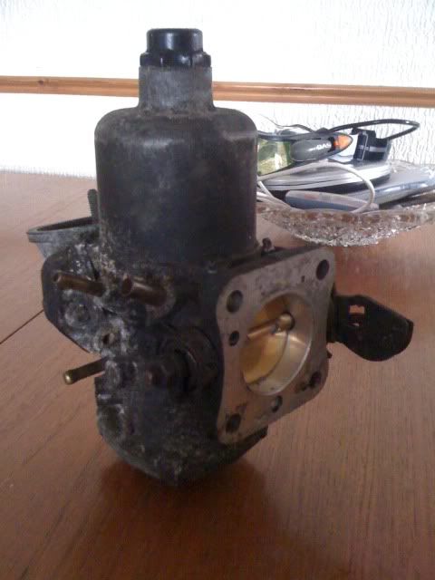

Cheers for thre replies guys, this is the carb I have
Will get come carb cleaner at the weekend the and follow my book

Its a HIF and therefore evil.
More so if the float bowl decides to clog, Hs's you can sort on the car.

Be careful if you throw carb cleaner all over it, there are rubber seals and i'm not sure how they react to it! You can remove the throttle spindle without effecting any of the tuning, it's just 2 nuts, and the 2 screws and it slides out, not the positioning of the springs though! The elbow can also be removed, and then you should be able to see straight through the bore.
The choke assembly could also be removed, the dash pot too, be careful not to push the brass/silver flat round section in the centre of the carb body once you remove the dash pot, you'll see what bit i mean :D
In your position, i would leave the float chamber alone, if it was running it "shouldn't" be too bad inside, the outside looks different though, block up all the pipes too before you clean it, stops all that black nastyness getting inside where you won't go.

Cheers for the reply Globule, will prob buy some carb cleaner at my local motor factors trade place (cheep as chips :D ) and attack it at the weekend, i'm aware of the rubber being quite sensitive to solvent cleaners but thanks for the heads up. Will take loads of photos and see where i get

People like the HIF's for the central bowl that stops petrol starvation at high speed cornering.
They have a few seals because of this and all the main works of it are in the bottom.
A HS carb has the bowl on the side, so you can just pop the top off when you need to (change needle, clean out, etc) but suffer from cornering and fuel starvation. Which I never had, maybe its more a track car thing.
If a HS4 gets clogged, its 6 screws to remove the bowl and the needle (with the bell thing as well, piston, whatever you want to call it) which can be all done on car. With a long screwdriver you could disassemble the whole thing on the car if you where lucky and persistent enough.
I just don't like the design of HIF's. I'd rather stick with the simple HS carb.

are HIFs more tempermental or are they just a bit more fiddly to work on?
Little more fiddly to work on but That's the only reason i can see that some people would choose the HIF over the Aged HS, apart from being scared of change, lol.
HIF overall build quality is miles better, as is the body casting, There's additional features such as a small bearing and race in the dashpot for the piston, the throttle return springs are stiffer, the machining on the inside of the carb is much finer, and the elbows are a lot smoother in terms of air flow, and there's a nice little circlip in the top of the piston. Mixture is not difficult to change,.. you can even do it with a plectrum and you don't have to risk touching a hot manifold to do it.
Don't forget that HIF38's are all a newer design and Younger than HS4's (unless you have bought new) and so naturally, have not had much of the wear and tear that the the majority of HS4's have had to put up with -
Nothing wrong with HS2/4's at all providing they're in good, regularly serviced condtion which unfortuinatley they are rarely not. But I will tend to lean towards the above qualities of the HIF's to base my decision on what i prefer.
What ever you chose - It's wise to strip and clean it,.. and if it's an Hs4 i would be tempeted to get a rebuild kit no matter what.
