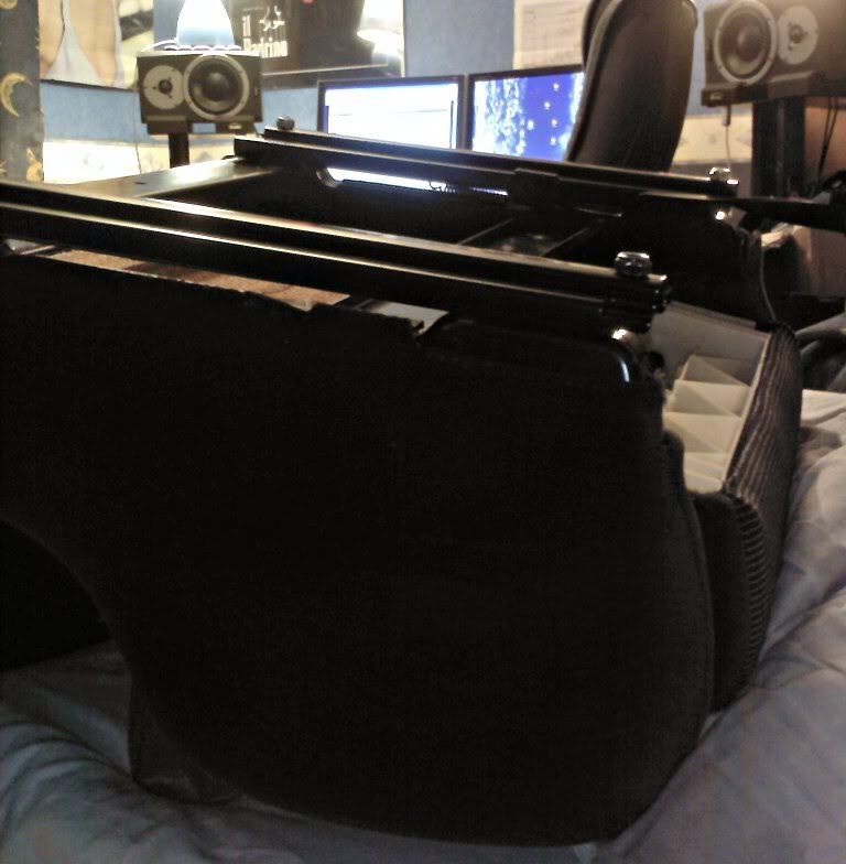

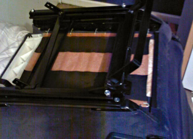

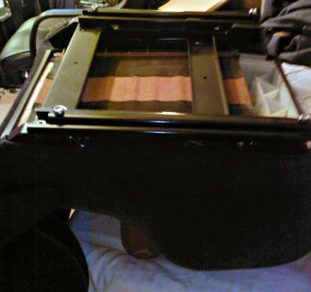

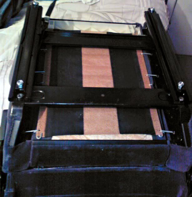

heres some pics, although they dont do the seats justice, they were taken using my phone
this one is my idea to put a crossbar made from 4mm steel with 2 extra holes drilled to allow using the bits from the universal subframe kit, this would mean that no modification or drilling of the floor is needed and you could still refit the original seats at a later stage....can you see any problems with this idea? i'm thinking if make the holes big enough or have them milled out a little i can leave room for some adjustment too.
thats all i did with my bucket seats just used bits from the mini subframes i brought ,i just off set the drivers side seat so the kids can get in the back.
