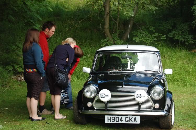

Then i added some Angel Eye headlights:
Then i added some more (bigger) cibies:
thats pretty much what he looks like now!

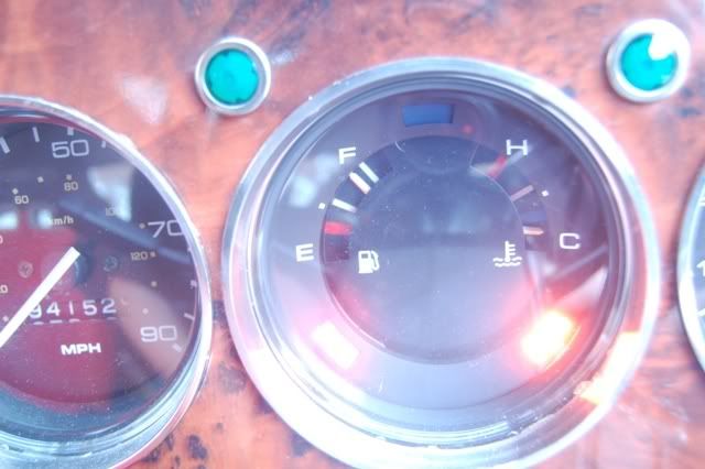

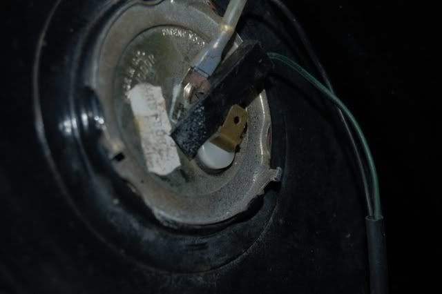

Tonight I took a look at my petrol gauge because it wasnt working
was hoping it would be something that wasnt technical because im a bit scared of luckily i found this:
connected the black wire and:
Posted Image woohhoooo!

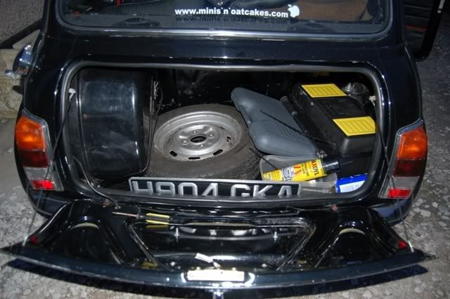

probably because of all the *rubbish* in the boot:
Posted Image cant wait to get a boot board...

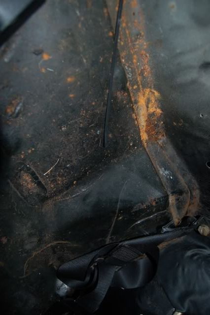

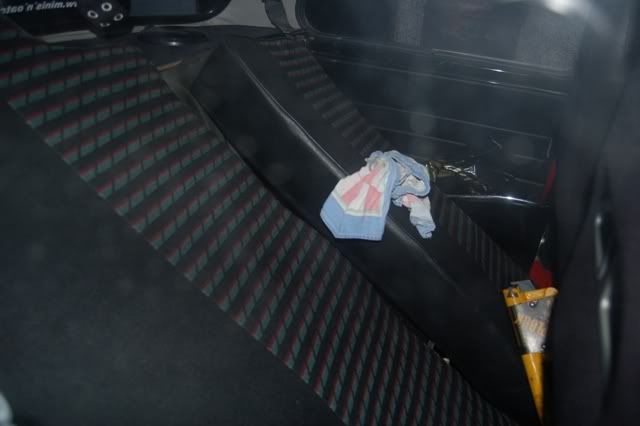

took out the back seats (in the dark fubling around) ready for taking to be re-upholstered,
and found some ruddy orange stuff, looks like its only surface though, whats the best way to get rid of it? i was thinking sandpaper, zinc primer and paint with hammerite... this sound ok?

yeah dude, get some coarse sandpaper on it, sand it down as much as you can, then rust treat it, wait for it to react/dry then hammerite should be plenty good

going have to do something about it, to the left theres a little pool of water so i wonder if its one of the window seals leaking a little,
maybe the rear one as every now after heavy rain therell be a bit of water under the 10'' in the boot...
