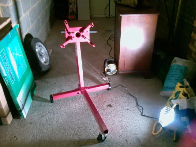

Posted 26 November 2008 - 10:35 PM
just put together my stand. ordered monday morning and arrived wednesday, not bad.
heres a pic:
im still not really sure how you support the engine with it :s any more info on these adapters guessworks? or pic of yours?

Posted 26 November 2008 - 10:51 PM
Thats what i was thinking when i looked at pictures of it. Looking at that pic it looks useless to me!

hmmm please dont say that :thumbsup: but its a good point. i just dont get how you attach an engine to it >_< might be a bit of a problem seeing as the engines coming out on sunday

Ideally you want two 1/2" bolts to attch through to the alternator mounting. Can you get two of the arms to swing together that close?
