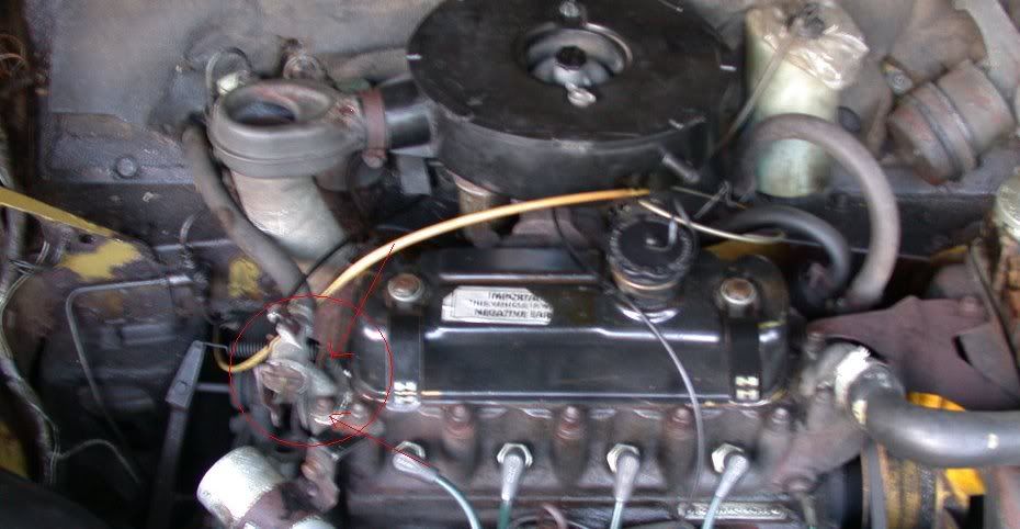

#13 benb12
benb12
  • 1,483 posts
Posted 03 December 2008 - 05:29 PM
The thing circled in red. When you pull the heater knob out it will pull the little lever on the valve and open it so that water can circulate the heater matrix.
#14 Shylos
Shylos
  • 545 posts
  • Location: Minnesota
Posted 05 December 2008 - 11:21 AM
Ah ok, thanks a lot for the picture :w00t:
