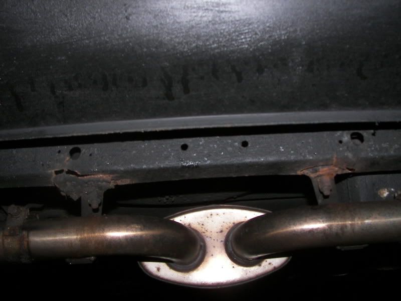

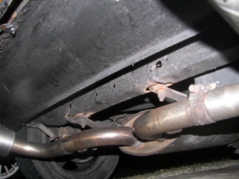

Just home from work and got under the car..... no need to get a photo, with having more time to look - it was -2 at 6 am this morning and was already late for work - I just looked with no intent.
I can see where the previous owner has welded the brackets to the subframe - and its the welded area that is weakened and rotten. Its then snapped and taken part of the subby with. Although it looked fairly good - the weld and rot has weakened the structure and led to its demise.
