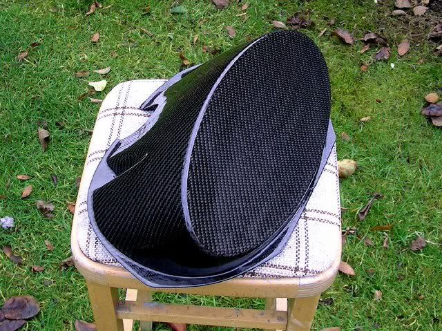

Yes me and nick (aka the carbon weezel) have made all of the carbon for my car. Usually starting with me designing it on paper and
then chatting to nick about how we could go about making it. This is how Carbon Weezel started, Me and nick were always trying to think out of the
box when deciding what to do with my mini project. Most of the carbon he makes has started out life being a mould for my car and yes the rocker
cover was a one off originally too im afraid. But if your interested and he gets a few enquiries Im sure he would think about making a few of them next year.

Hi mighty mini jack and lewis, Yes I did make the brace bars myself. I am unsure what guage the steel is though, It was rolled steel that I welded solid bar into either end. I then drilled and tapped left and right hand threads into them for adjustment. The only tricky bit was getting the passenger side around the big aluminium radiator. Definitely prefer this look to that of the square box section ones that they sell everywhere.
