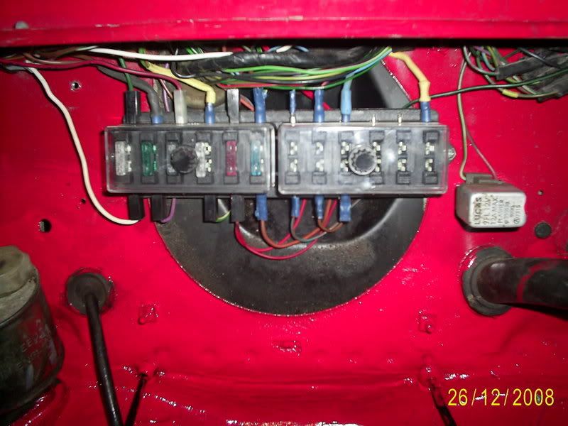

replaced my fuse box and inline fuses today
the inline fuses all had 30 amp fuses in them, this seems a bit high for some of the wires
anyone know what size fuses for what colour wires ?
