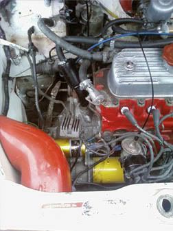

is it the yellow thing at the bottom that im supposed to hit?
also where is the solenoid?

Yes, the "yellow" thing appears to be an inertia starter. With inertia starters "whacking" them with a hammer isn't always necessary. They have a small extension of their internal shaft that pokes out (to the right as you stand looking at the engine). That small bit of shaft has a square profile so you can put a wrench on it and give it a turn. Try that first before using a hammer.
Rocking the car works if the Bendix unit of the starter is stuck in the flywheel ring gear. Whacking the starter can help to un-seat a stuck solenoid on an pre-engaged starter (later type... not this type). Sometimes whacking an inertia starter will help to shake the motor brushes loose... but save this for later. Turning the square shaft on an inertia starter will hopefully move a clean spot on the commutator under the brushes.
However, the real issue you've got here is a single "click" from the starter system. There are several ways to determine whether the problem is the solenoid. Since you were unfamiliar with what the starter motor looked like, I'm going to suggest what may be the safest test method but not the easiest method. Follow the big wire back from the starter motor and find the solenoid. The solenoid will have two big cables on it (one from the battery and the one going to the starter motor). Take a set of jumper cables and connect one end of the black jumper cable lead to the big cable terminal on the starter motor. Make sure the bare metal on the jumper cable clamp is NOT touching earth... only the metal post on the starter motor. Look at the solenoid and take the other end of the black jumper cable lead and CAREFULLY touch it to the solenoid terminal coming FROM THE BATTERY (not the one going to the starter motor).
When you make this second connection you are bypassing the solenoid. Power from the battery will be routed to the starter motor via the black jumper cable lead. The starter motor should spin up to speed. That's why it is imperative that you place the gear selector in neutral. IF the starter spins up to speed when you do this, your starter motor is fine. If the starter does not spin and all you get is a big, fat spark when you touch the cable to the solenoid terminal... the starter is bound up for one reason or another and is not working properly.
