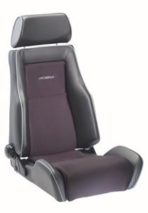

I'm thinking about changing my front seats and have seen these, Cobra Le Mans:
I was wondering if anyone else had them and how well do they fit in? And how much room do they leave in the back?!!

fit well + very comfy
but they foul the window winder at the bottom, excuse to fit electric windows.

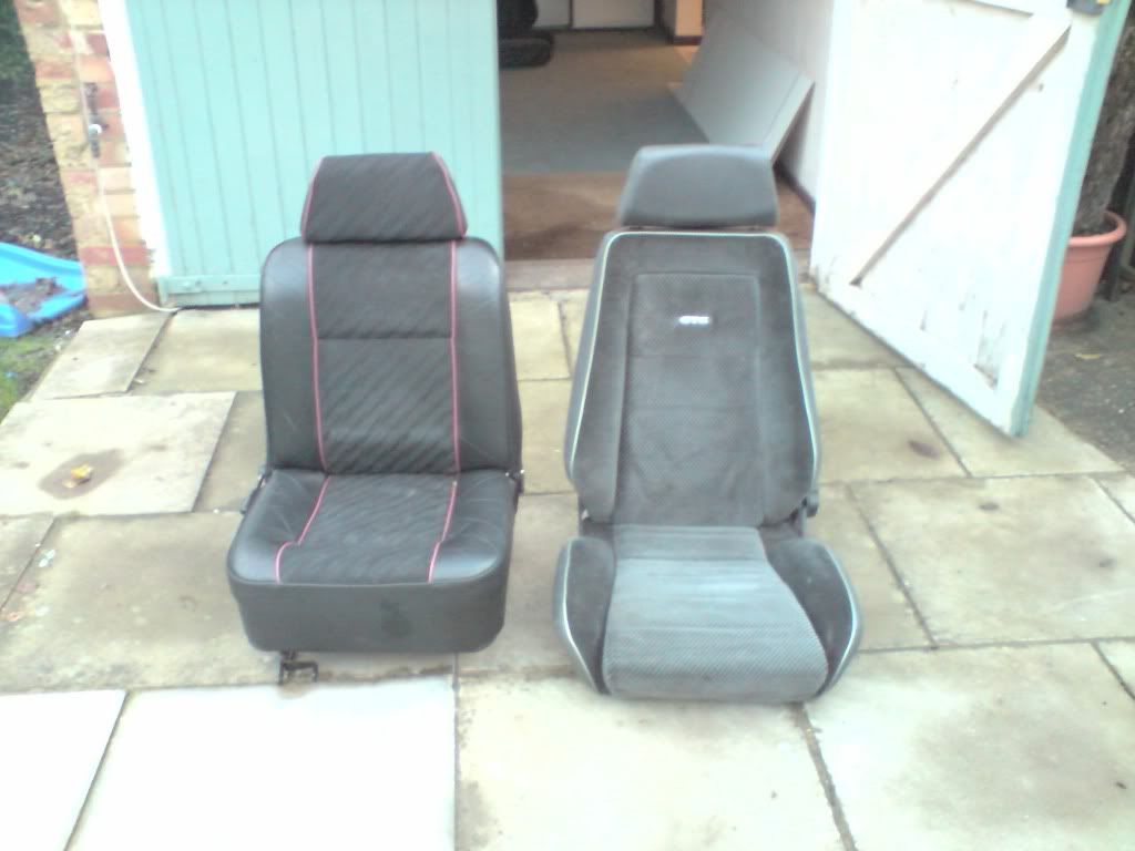

Yeah, recaros are similar.
Here are mine
There not in yet though, but they are very comfy!

Oooo, Recaros look nice too!

Recaro's dont foul the window winder if you dont use the standard seat mounting points. Whilst replacing the sills I cut half the seat mounting cross member away and lowered the seating position by nearly 50mm. My seats now bolt in to the cross member but I have lost the tilt facility.
Very comfy and I sit really low in the car. Also increased the distance from wheel to seat back by a further 3 inches allowing for my long legs.
