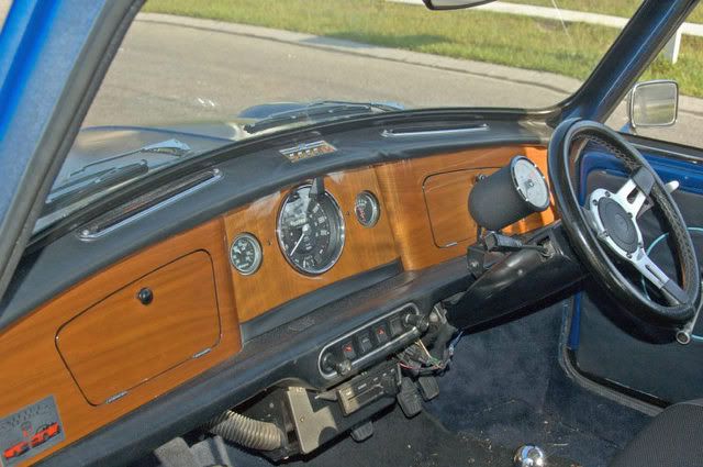

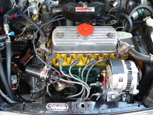

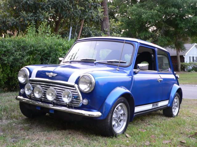

Here's some pics...

Well... unfortunately it looks like none of the above models any more...
Ideally, if you still have the UK Registration Doc then that would tell you... however from the VIN I can tell you it's not a mayfair..
so City / City E or a Ritz ( which was an LE City )
The engine number will differentiate between a City and City E ( as the final drive was different on the city E, 2.95:1 ) you can check that here.. http://www.guess-wor...ical/engine.htm
If you have the VIN tag, then also look for the paint/trim code, All Ritz's were silver therefore paint code MME and trim code JCH

Looks like its got fixed rear side glass which suggests city too.

I'd say it's a City of some description but it has been heavily customised. The E stands for economy so lower diff ratio and higher compression.

Well it's got a Chassis tag and not a VIN tag... so could be absolutely anything... Also being very odd to have a 998 with air con ( unless you've fitted it )
I think you can safely say you are never going to find out the originality of that vehicle as it's probably been 'butchered' to get it into the US..

Yeah I was going to say the presence of the chassis tag made it older than a 1985 car. The identity is older I mean, not any of the physical parts that are currently fitted because even the body probably started life as a different vehicle. Like most more modern Minis that have been imported to the US, your car is a real bitsa. I don't think you'll ever be able to find what any of it was orignally, all you can be sure of is that it didn't all start as one piece so you can probably pick any one of a few different identities if you want.

Although, im not sure if mini city's or city e's had a radio, I know Ritz's did, and you seem to have the original arial hole aswell.
It's going to be very hard to tell what you've got as everything has been replaced, one of the most outstanding features of the ritz was is vibrant interior. The dash rails, clocks shroud, and seatbelts were blue. The door cards and seats were cream, orange and blue. But seeing as how it's been completly changed it doesn't look like your going to find out. If you had any documents from the UK it might help, but as all of the paperwork has been changed it seems unlikly.
