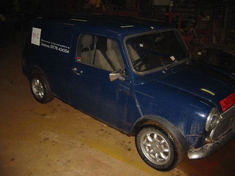

Posted 09 January 2009 - 05:18 PM
ive got a van with 13x7 wheels and sports pack wheel arches of a late mini look good.
will post some pics if i can find out how

Posted 09 January 2009 - 05:53 PM
AWESOME!
Is the wheels/tyres touching/rubbing against something anywhere, or is it an easy fit?
Bigger looks better, allthough off course, with my 850 engine, I should probably stick with 10" due to acceleration not being the awesomeness itself even with as small wheels as 10". ;)
