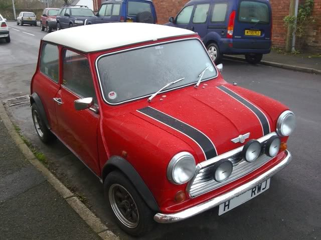

With regards to wether those arches will fit finchy, i think they might just cover, if not you will need to go for huddersfield group 6 arches (very similar). The best way is to bolt on the wheels, then measure how far they stick out. All the arches state (on the website) how far they stick out from the wing and go from there :)

hello mate iv got standard plastic arches and they sit 0.5 centimeters outside these i have huddersfield anthracite and they do catch the front on full lock cut the bottom lip out a bit and it solved the issue but ive since been told that raising the suspension with a washer on the knuckle joint would have sufficed however my old man has the same wheels and no rubs at all so i would suck it and see. i love mine and they fill the arches a treat!
