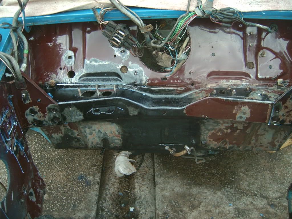

When I came to restore my mini and stripped out the engine bay I noticed a previous owner had replaced the brake master cylinder. They never put a seal back between the master cylinder and the mounting plate that the top engine steady fits onto, also that mounting plate had a rubber gasket that had perished and that’s where the water was getting into my mini. Hope this helps you out see graphs below.

I have exactly the same problem - when I wash the car (even by hand) water pours into the drivers footwell down the clutch and brake pedal arms. I took both master cylinders out and replaced the foam gasket that goes under the torque arm plate and the gasket that sits under the clutch master cylinder, using plenty of gasket sealant, and it still leaks! We're not talking a drip here, the water pours in around the pedals. I am wondering if either the foam gasket (got it frm Mini Spares) isn't really water tight or if it is getting in somewhere else. There are no obvious gaps anywhere and the body isn't rusted through anywhere. All the cables and wires have rubber grommets fitted. I noticed in your pics another big hole close to the wing - on my car there is a big nut and a rubber seal in there. What does that do and could water be getting under that and into the footwell via the box where the pedal arms go? It seems to be sealed OK but I can't think where else the water is getting in.

i think the big bolt your talking about is the tower bolt for the sub frame and that wont let water into the car
