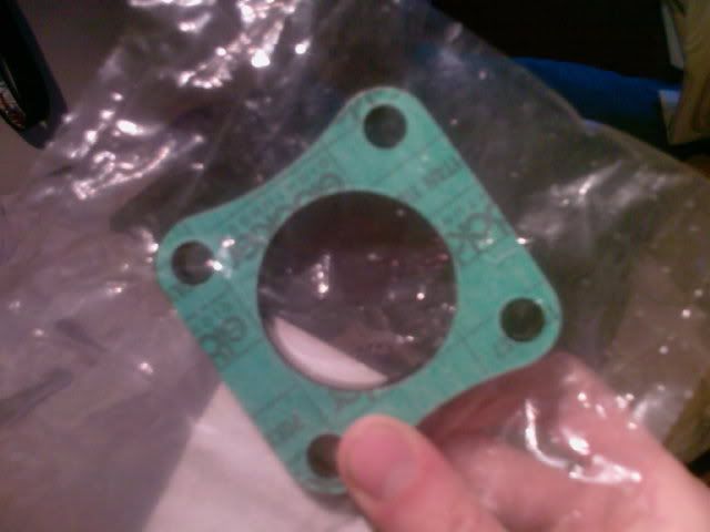

Sorry if this is in the wrong section, I wasnt sure where to put it. Also, ive searched but couldnt find what I wanted :)
On friday im getting a new carb fitted to Lily. Im going from having a HS4 on her to what Im pretty sure is a HIF38. I was told by the guy whos fitting it that I need to get a spacer. I ordered this one but have a feeling its too big (for a HIF44?):

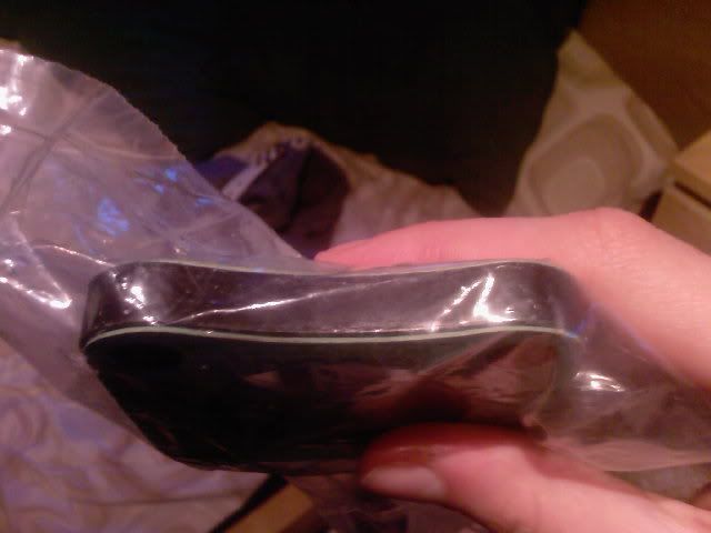

Also is the spacer too thick?
Its going onto my 998 with a stage one inlet and I also have a Pipercross pancake filter :P Anything else you need to know?!

Saz - measure the diameter of the big hole :)
#3 sazal
sazal
  • 3,512 posts
  • Local Club: DCMOC
Posted 17 February 2009 - 05:43 PM
Haha, why didnt I think of that!!
Should be 1 and a half inches, yus?
#4 GreaseMonkey
GreaseMonkey
    Has Ratchet, Will Make Noises
  • 3,663 posts
Posted 17 February 2009 - 05:45 PM
Correctamungo!
1.5inches is about 38.1mm which is where the the Hif38 gets its name from.

Looks like a 38, if it is for a 44 it won't make to much difference if the manifold is also. In fact it'd be better than using a small one, but don't forget the abutment plate hole.

Its 1 and 3/4s, so for a HIF44? :)
Does it need to be as thick as it is, as I think this is the only one they had that was this thick.
Also can I just use my 2 hole one thats on does it need 4 bolts?!
Edited by sazal, 17 February 2009 - 06:00 PM.

The thin bit of steel the outer cables connect to. Yes you can use the HS4 spacer. I'd use all 4 studs if you have them but tighten the 2 through the spacer first.

ohh and that is the normal thickness for the spacer
