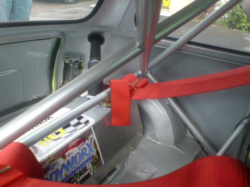

Posted 20 February 2009 - 01:14 PM
My mate Darrens old Pro Motive demo car with no rear seats, as you can see a strong roll cage would be needed
