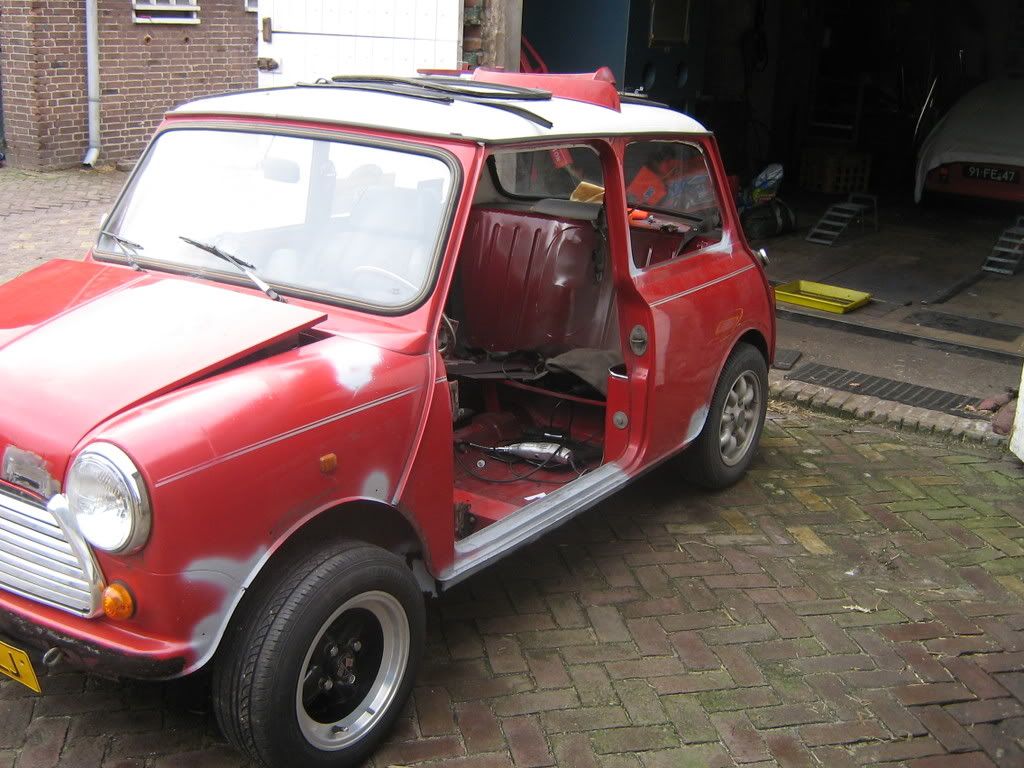

I've been busy with some body work, it wasn’t easy. But we are making progress

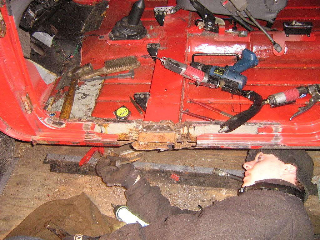

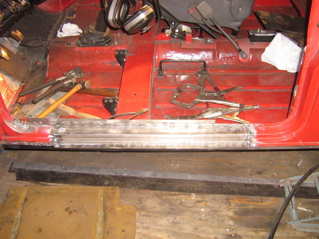

I have put in a new sill. I later found out, it is better to replace the hole sill in stead of a part.

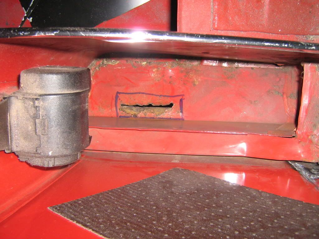

Oh bugger, I found another hole.

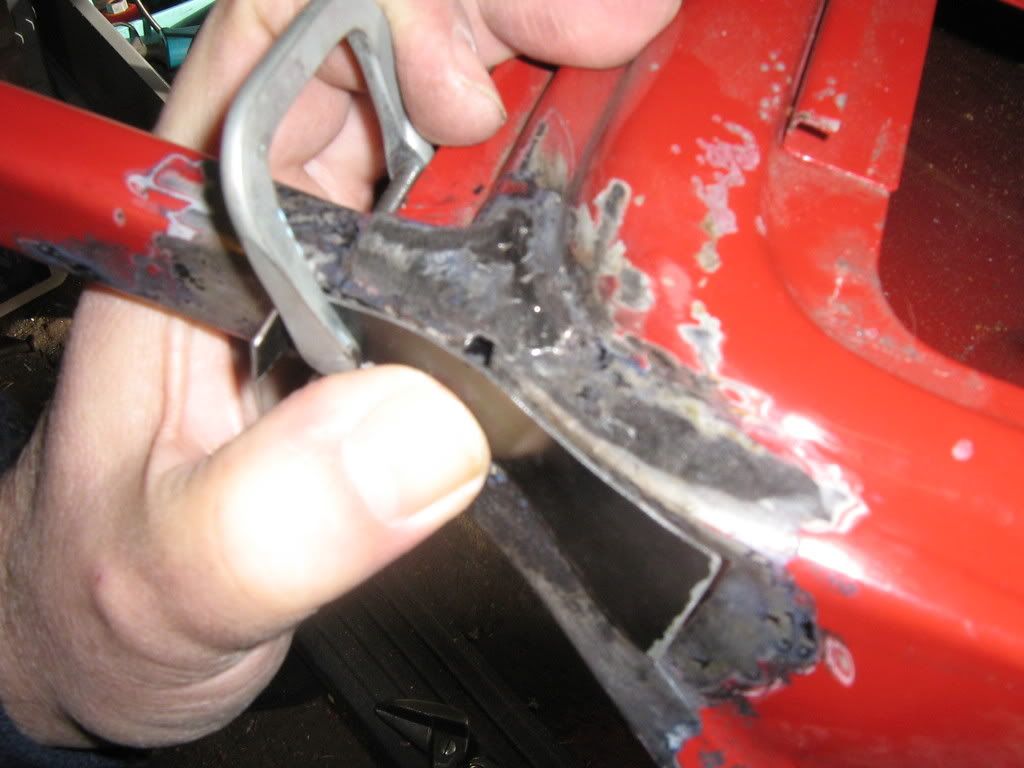

Did some minor repairs to my driver side door, it wasn’t to bed.
I later found out that the hinge mounting point had a crack I think we did a nice job. The door will be prepared to paint next week.

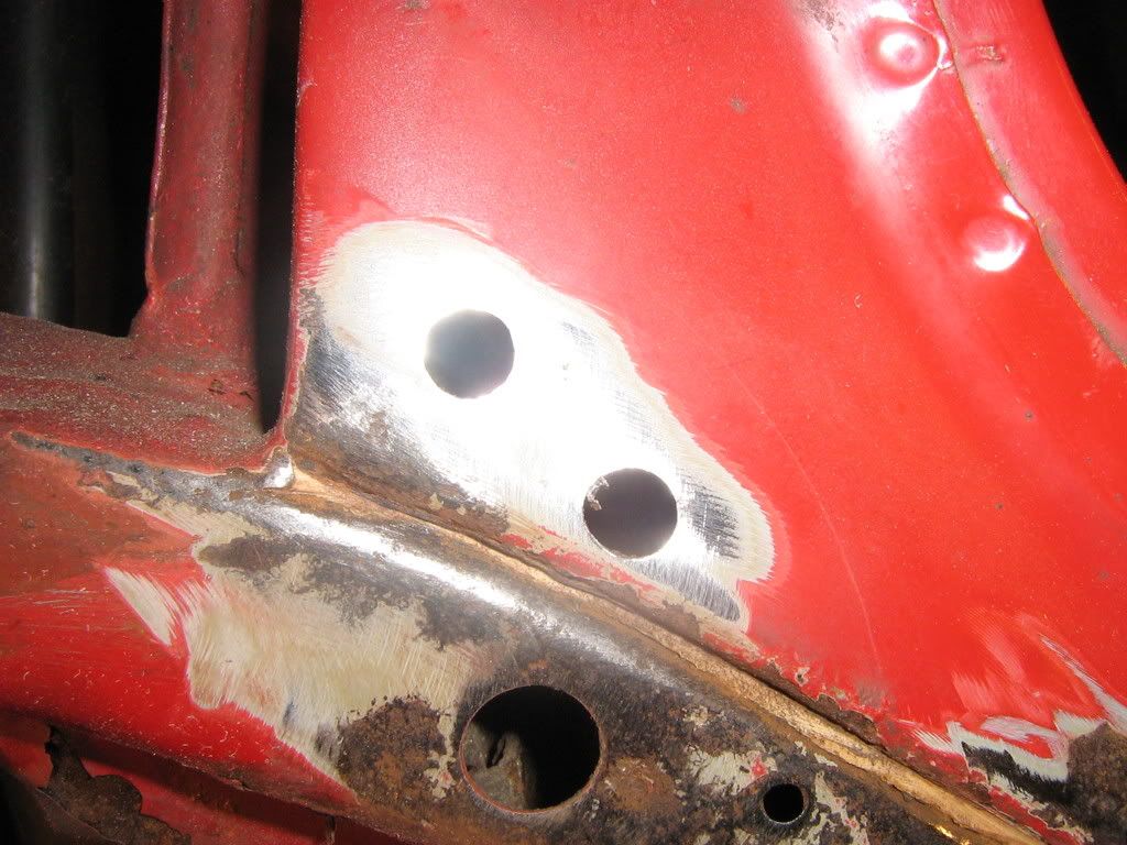

Today we got rid of some rust on the left wing, spotted a new hole drilled it a bit bigger and welded it . I used a piece of aluminium on the other side, this works very wel.

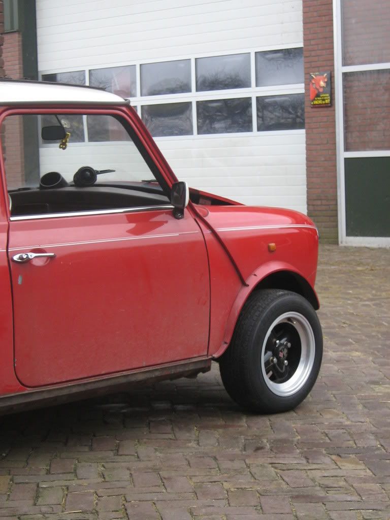

I am gone change the bonnet a bit I think it looks great.
