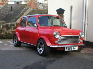

heres mine on 13x7 starmags, standard suspension apart from ripseed hi-los and AVO adjustable shocks, it handled well and used to take any corner at speed.. but i've never driven another mini so i don't know any different lol
