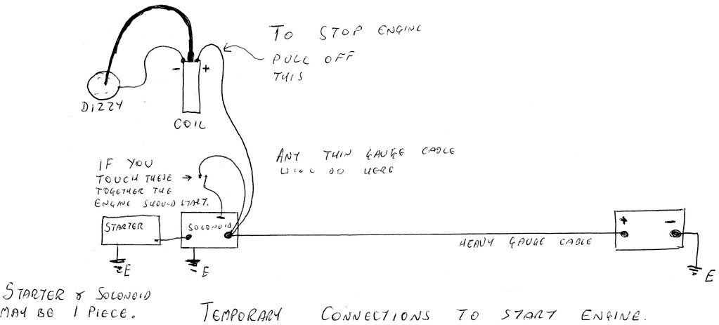

I just drew this in about 30sec (as you can tell) If you remove any wires from the coil and dizzy and fit just these you can temporary start the engine.

well followed your advice great68 but when i attach 2 wires together i just get a click sound and i then have to take off battery mains and put on again. is this just a dud battery??
sounds like its opperation the solinoid but not enogth power to start. bung the battery on change for a while if you can (or if you have another car, try it the jumpstart methd)
