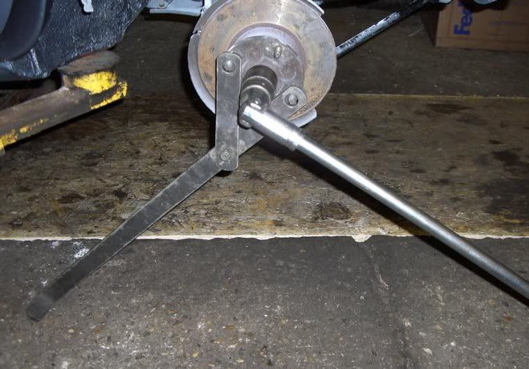

Hi..make yourself one of these...........
......you only need one person................ :thumbsup:
