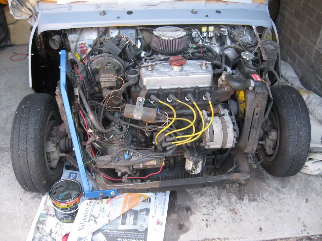

Filter sits where the original one was, with a jubilee clip to hold it on, sensor sits in the back of the K&N, red hose is blanked off with a screw.
