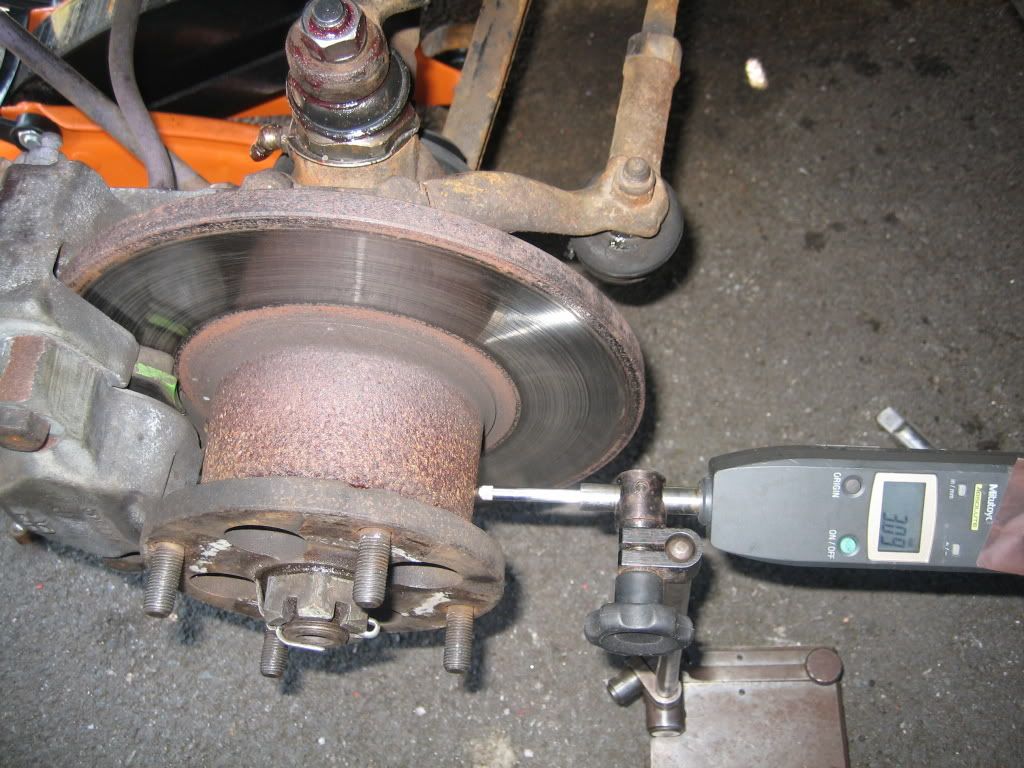

Also did you clock the discs up when you fitted them, best to keep below 0.006" side to side runout.... however a lot of the cheaper discs also runout in a circular (concentricity) motion.........

Well, didn’t manage the suspension cones, not enough time to remove the top arms, but I did a few more measurements, and found that the cental hub on one side is 3mm off centre! See pic. Now these weren’t cheap, I purposely bought these, they were a bit dearer, but Pagid is usually a make you could trust?? Do you think this would be enough to cause it?
Now I need to find some quality discs, that are fully machined, as these ones were cast in the centre.
