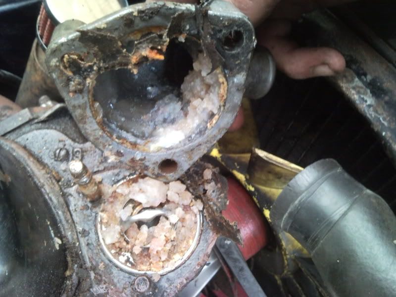

drove to the mot last week (about a mile) and when i parked up there is steam pouring out from the over flow pipe down the side of the rad.
anyway ive taken the thermo stat housing of as the engine had been sat for a while and it could do with a new one.
and i found this =]
wax stuff in rad..
underneath stat
what is it and has it come from the rad or the thermostat?? or elsewhere??

Looks like the remains of radiator seal stuff... horrid stuff.
If I was you i'd flush the whole system with 50/50 white vinegar and distilled water - bring car upto temp then drain and flush with clean water.
Yer a good flush of the system should do it some good =] .

yeh i have to admit rad seal is shocking i made the mistake of pouring some in and now im having coolin problems so im gonna have to wip the head off next month

Check if the thermostat works it's not called a waxstat for nothing.
yeah i soaked the rad in boiling water and vinegar for a couple of hours.. and it seams to have clear most of it.
also replace the stat with a new one, so im hoping the rad is saveable.. ?

Looks like the stat has disintegrated.. the wax has come from inside the stat itself, that's how it works. When the coolant heats up, the wax expands which is what makes the thermostat open.

yeah im hoping its the stat that was old and knackerd and not the rad thats on its way out. suppose i will see when it goes back for its mot retest monday.
