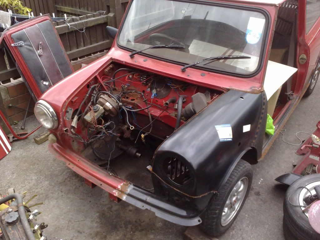

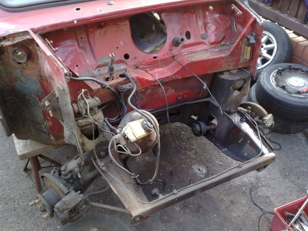

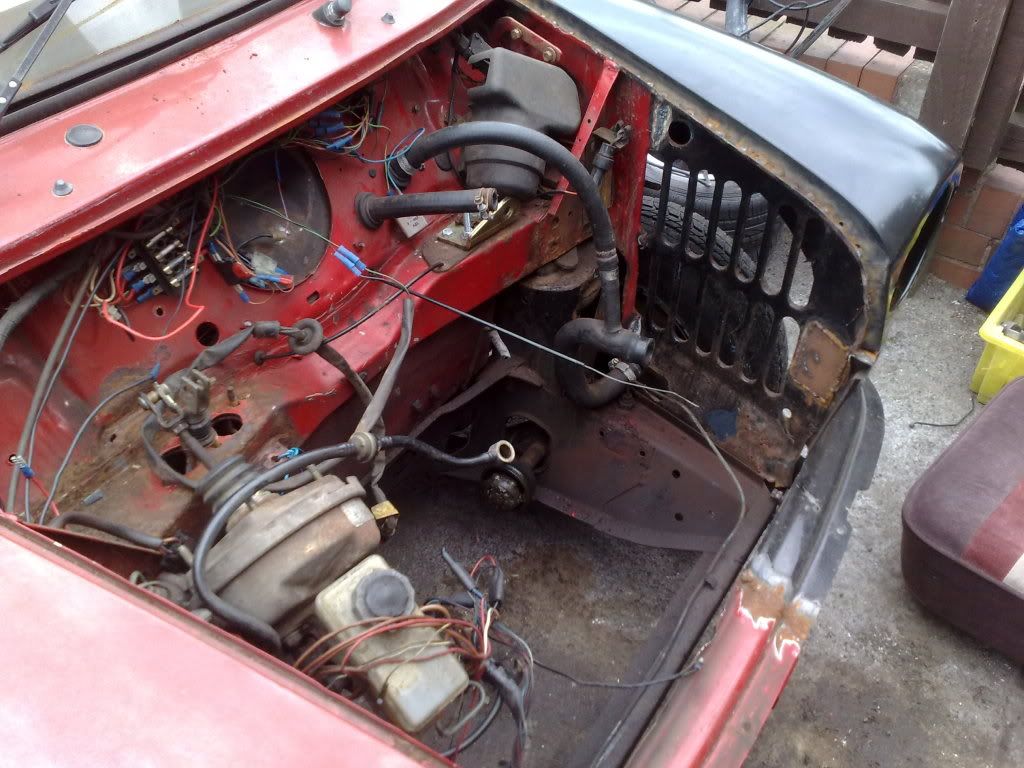

#11 mikey362
mikey362
  • 92 posts
  • Local Club: SYMOC
Posted 01 May 2009 - 12:21 AM
so now photobucket has let me upload photos so heres some pics
theres still abit to go and ill be takin the front down to bare metal, or at least as much of it as i can due to needing the car to stay move able
mike
