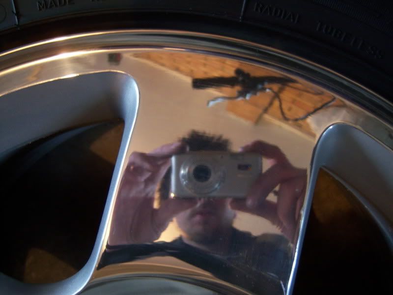

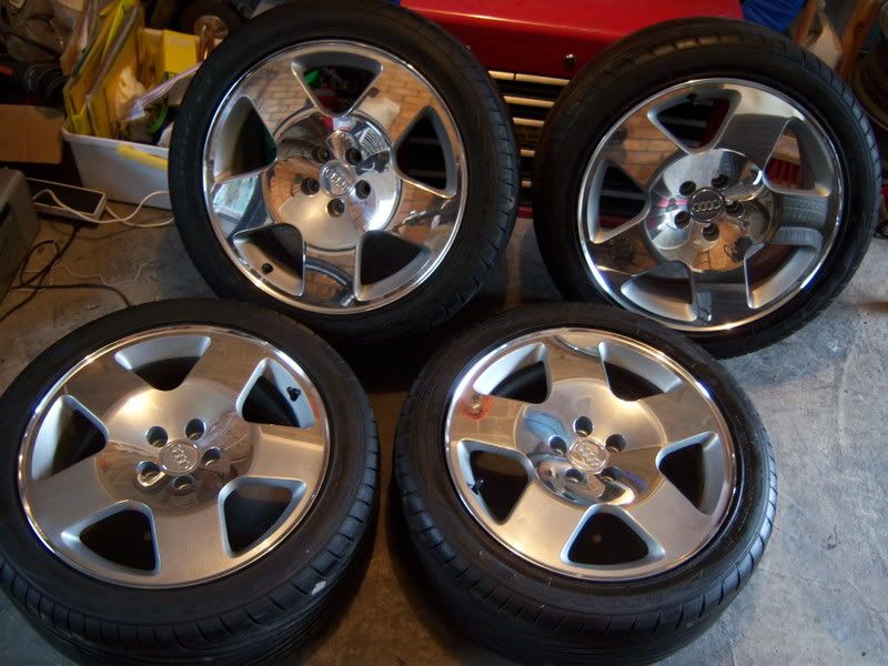

I have done a lot of mirror polishing in the past and used a similar product which is no longer available,it adhered to the surface not too bad however it dulled the finish a lot.Similar to the dulling effect of the lacquer you would find on the original diamond cut finish on your superlights.I only used it as the guy i polished the wheels for was insistent they should be lacquered.
These are the wheels that were done but cant seem to find any after pics but the finish was nowhere near as good afterwards.
For a proper mirror polished finish,autosol is miles to harsh and will dull and leave scratches after just one application.You should use something like Belglom alu for normal use and for slightly heavier tarnishing use meguires metal polysh.They should be washed as regularly as possible and waxed with a good protector such as rimwax or similar after each wash.
