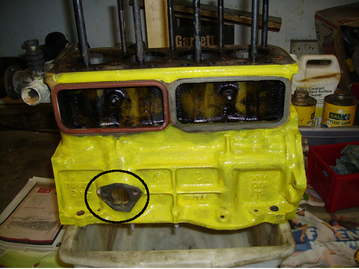

is this (the circled bit) were the speedo worm gear lives???
#12 M44K TS
M44K TS
  • 3,104 posts
Posted 03 May 2009 - 12:59 PM
I think that's where the mechanical fuel pump sits

#13 yeti21586
yeti21586
    He's A Lumberjack And He's OK
  • 3,725 posts
  • Name: Chris
  • Location: Hampshire
  • Local Club: None
Posted 03 May 2009 - 01:02 PM
ok so were does the speedo cable

#14 monkey
monkey
  • 1,382 posts
  • Location: Diss, Norfolk
  • Local Club: Diss Mini Club
Posted 03 May 2009 - 02:27 PM
If you take the rad out, and just follow the speedo cable down with your hand... not the easiest of things to get to
#15 MRA
MRA
    Previously known as 'mra-minis.co.uk'.
  • 7,607 posts
  • Location: Due to move again....
If you follow the link, and in the left hand lower part of the picture there is a black cap..... underneath is the speedo drive boss that the cable attaches to.... :X
