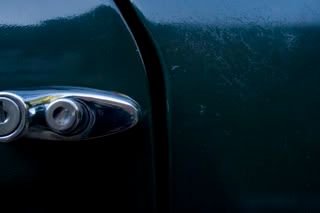

Here is the paintjob, clearly you can see it's badly finished.

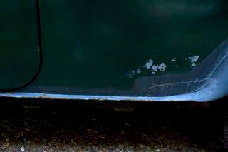

Also here are my unfinished sills

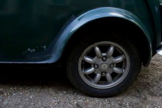

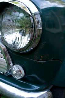

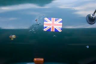

And here is the rust under might lights and the rust bubble next to aerial.

Well the top photo looks like it's been patched for the MOT? So perhaps water is entering the car from there, or maybe the door seals need replacing. Another favourite water leak hot spot is the front windscreen seal and water will happily fill up your foot wells from there.
As for the rust, well any good Mini friendly body repair specialist can sort that out for you. But it's really up to you and how much money you want to spend on either repairing the affected panels or replacing them altogether.
The rust on the front wings is common around the headlamps and on the top of the wings due to damp muck getting stuck between the inside of the front wing and the air vent trunking causing the problems.

you may also like to take a very careful look at the air vents.... if you have them it looks like a 90's onwards to me what year is it ? oh yes the air vents.... look from inside the wheel arch, and have a gentle prod around just use your finger to see if there is any give... not trying to poke holes as this will just make it worse :thumbsup:

I'll check under the arches later.
For the sills - do you think I should have them sanded down and the put the sills on, or just put the sills on as it is (after painting).
Anyone with advice on the current painjob? (You can see in the picture with the door handle it's badly finished)

I'd definately check out the water leak as your first priority because if water is getting in it will only sit there and rot away at your floorpan.
After that, as Taffy said it's entirely upto you how much you spend and what you want to get done. If the rust is coming through like that, chances are there'll be a whole lot more rust in your sills, front end etc and if you start poking around you'll find even more work for yourself... if you're a perfectionist you would go hunting every last bit of rust but if you're mainly concerned about the cosmetic look of the car then get the bubbles rubbed down & sprayed over. In my eyes its pointless getting a full respray because if you're going to that effort you may as well strip the whole car down and like I say, you'll end up finding more work for yourself :)
