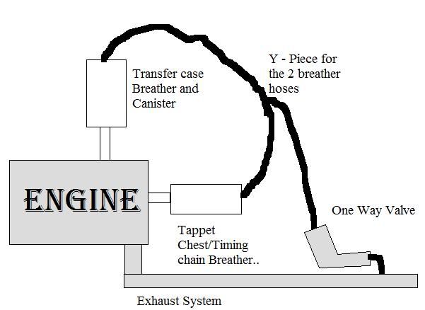

Further Thoughts into this
Would the Following system work..
Questions about it:
1. Would i need to involve the Intake System, as surely the exhaust system always has a vacuum?
2. Would the Exhaust side need a PCV valve aswell as a 1 way valve?
3. Do i need an oil catch tank?
4. If i need a catch tank, where would the best place be to return the oil to the sump, if at all?

from Vizards book- this is why the PCV is needed:
At idle - the vaccum in the intake manifold draws air out of the crankcase through a PC valve. When the engine is under load there is no vaccum in the intake manifold because the the butterflies will be wide open on the carb.
Under such conditions, the high speed passage of the exhaust in the collector part of the exhaust manifold will cause suction on the pipe connected to the anti backfire valve. This will draw air out of the sump.
The anti backfire valve also seals the system at idle so that the exhaust isn't drawn into the intake manifold via the crankcase and the PCV valve.
#11 liirge
liirge
  • 4,097 posts
  • Local Club: EDMC AND MMC
Posted 01 June 2009 - 08:14 PM
That's what i read, but i was wondering if we take the intake system out of the PCV completely...there is surely going to be enough vacuum from the exhaust, pretty much all the time even at idle, to use for the PCV system. so thats why a PCV valve isnt needed, The Anti backfire valve only activates if there is gas coming back up from the exhaust, not into the exhaust.
Have i missed something completely?
Edited by liirge, 01 June 2009 - 08:15 PM.

i think there isn't enough at idle liirge.
I need to sit down and stare at the plan Vizard has made for a bit to understand it.
I know that Sproket knows of this mod too...

Hmm, maybe there isnt at idle then, there's a high Vacuum at the intake on idle, i know that, so it ,might be higher than the exhaust hense in vizards the oil mist goes there, but if intake is taken out of the equation completely i wonder if it would still just go through the exhaust...

Posted 02 June 2009 - 07:56 AM
Questions about it:
Not the best idea, would really mess up your emissions come MOT time, plus the exhaust really isn't a vacuum due to the silencer causing back pressure, it's just the exhaust is at lower pressure then inside the cylinders! Also how are you going to remove all oil mist without creating back pressure, (the one way valve will create back pressure too), and effectively pressurise your exhaust system, you'd be better to put it through a carbon canister and filter then straight to atmosphere.
The intake is at lower pressure then the crank case, (itself pressurised by blow-by), so the air flows round, you could create some form of pumping system to evacuate this air, which I presume the Evacupump (sp.) system does.
I'll see if I can think of anything that may work and be quite simple.
